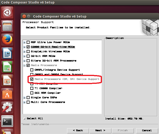

    You're right, there are no files there other than CC430 and MSP430.  I did as was suggested yesterday to add '6437 support but something must have not happened correctly.  (By the way, I'm using the Linux CCS6.)  What would you recommend to fix this?
    Dave
  • How did you 'add support'? Did you first do a custom install without installing it and then tried to repair your installation?
  • Yes, the original installation was done with only '430 support and later was I told I needed '6437 support as well. Yesterday I posted a question on how to do such a thing and Lisa suggested the repair approach.
  • yes that is the right way to do it. You did a 'repair' and added 'Media Processors -> Media Processors (DM, DA) Device Support' ?
  • Yes, but I checked only the specific processor type.  Should I have just let it do all the Media Processors instead?
  • You should only need the one I highlighted in red. That gives me DM6437 support. That is enabled when you rerun the installer over your existing install?
  • Ah!  Somehow only the "TI C6000 Compiler" option is selected.  So I don't need that one at all but do need "Media Processors", right?
  • Well if you plan on using the TI compiler to build your projects (and I assume you will since that is what you used with v3), then you need that also. So make sure you keep "TI C6000 Compiler" installed.
