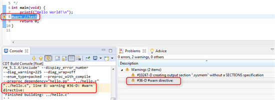

  • I don't think it is an indexer issue.  When I add a warn directive I see the indicator in the editor.  However I also see it in the problems view.  When I look at the console I can see that the compiler does spit it out as a warning.  Thus it is not an indexer thing.
    Plus if I add a second one and save I don't see the indicator.  It just shows up after build.

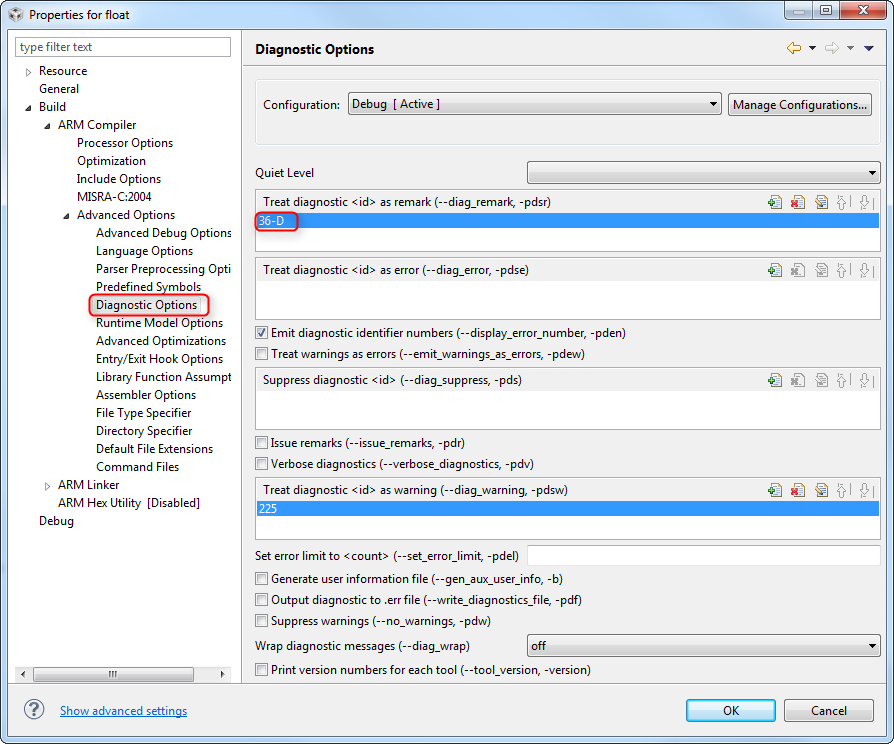

    What you can do is treat that particular warning as a remark and then it will disappear.
    Now when I build it is not there.  Note that it should be 36 and not 36-D.  The capture was wrong.
