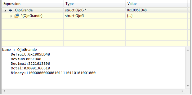

  • Could you look at the structure in the memory view and see which address the pointer to the array is pointing to?

  • This is the information:
    The struct has a valid adress but the array goes to 0x00000000.
    Any idea??
