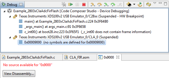

I am trying to enter step mode with CLA task 7.Code is getting compiled without any errors.But while connecting to CLA in debug mode,"No source available for "0x9000" error.
Can some body advice.

Hi Ravi,
user709121 said:I am trying to enter step mode with CLA task 7.Code is getting compiled without any errors.But while connecting to CLA in debug mode,"No source available for "0x9000" error.
I would like you to take a look on this article: http://processors.wiki.ti.com/index.php/C2000_CLA_C_Compiler#Debugging
Also, No source available errors can be ignored but do go through the above article and check whether you still get that error.
Gautam
"No symbols are defined" - Did you load the symbols?
Once the CLA core is connected proceed to load the project symbols by clicking on Target->Load Symbols-><test>.out (e.g. exp2.out).

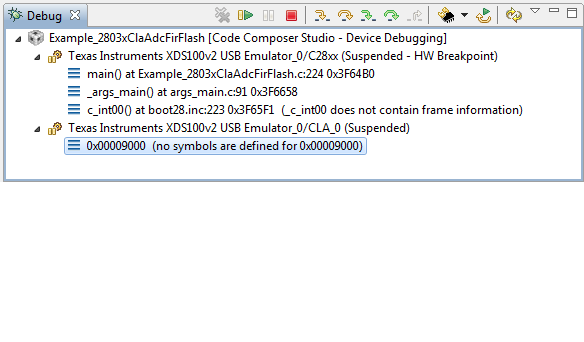

Mean time, pls find the steps Am following for debugging.
1. export the example program from C:\tidcs\c28\DSP2803x\v121\DSP2803x_examples\cla_adc_fir_flash to my work space.
2. Build the same......NO ERRORS
3. Go to debug mode by pressing F11.....XDS100V2 is used
4.Select the CLA and right click
5. Right click and select" connect to target. Error appears as below.
* Main CPU is working fine in debugging mode.
* MDEBUGSTOP is placed in task7
* Compiler is v6.2.6
Pls let me know whether these steps are correct.
Ravi.

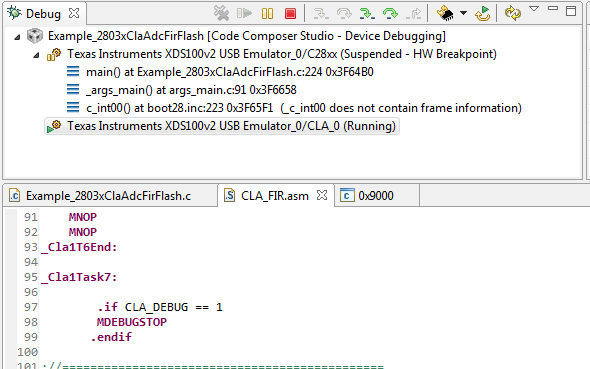

Hi Gautam,
Thanks for your suggestion.
After loading the Output file, Cla's status is "Running".But I find the following error
ERROR MESSAGE:
CLA_0: Trouble Setting Breakpoint with the Action "Finish Auto Run" at 0x3f64b0: (Error -1209 @ 0x3F64B0) Device does not support software breakpoints. If available, use a hardware breakpoint. (Emulation package 5.1.73.0)

Hi Ravi,
I hope you check the "Known Debugging Issues" mentioned in the above link. Also, please go through the video tutorial mentioned in the same link.
Gautam
Hi Gautam,
Now, I could debug in main processor and CLA as well.
Thanks for your support.
Ravi.

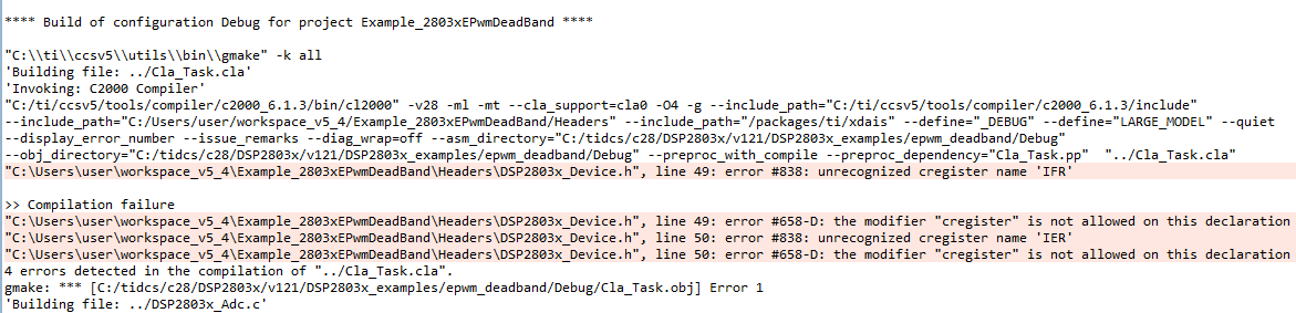

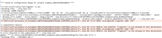

Hi Ravi,
In DSP28x_Project.h, please make sure that DSP2803x_Cla_typedefs.h is the first included header in that file.
Gautam
Hi Gautam,
I added #include "DSP2803x_Cla_typedefs.h" at first .
Still same error is getting reflected.
Can you advice.
Ravi.
Hi Ravi,
The above errors seem like some kind of include error. I would like you to refer any sample CLA based code and compare what's missing.
