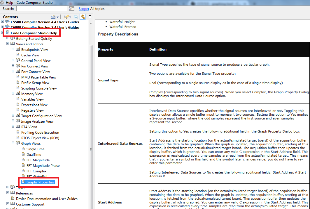

thanks for the information!! the links are pretty good.....the only thing is that i do not see definitions for the fields in the graph properties window and am not sure exactly what they mean.......please let me know if you are aware of any documents that define each.....thanks
Hi Mark,
Mark Santacesaria said:the only thing is that i do not see definitions for the fields in the graph properties window and am not sure exactly what they mean.......please let me know if you are aware of any documents that define each....
Check the Help that comes with CCS (Help -> Help Contents)
