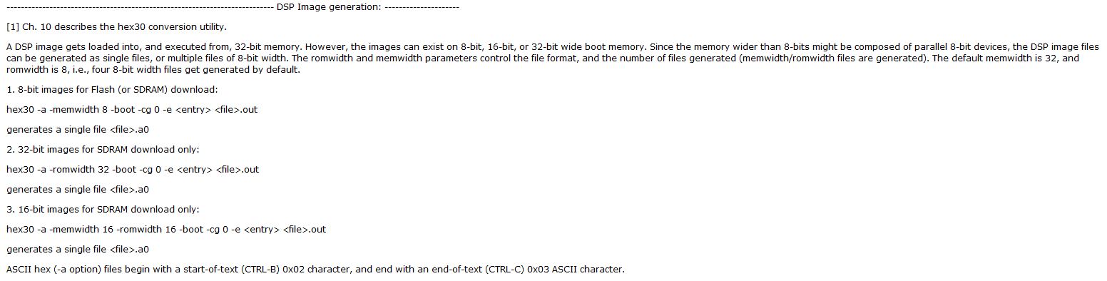

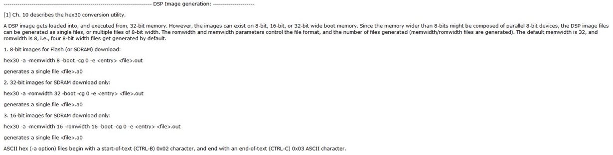

Hi Gautam
Thank you for your reply.
I watched URL you introduced.
but I could not understand, What eventually difference?
Hiroyasu
