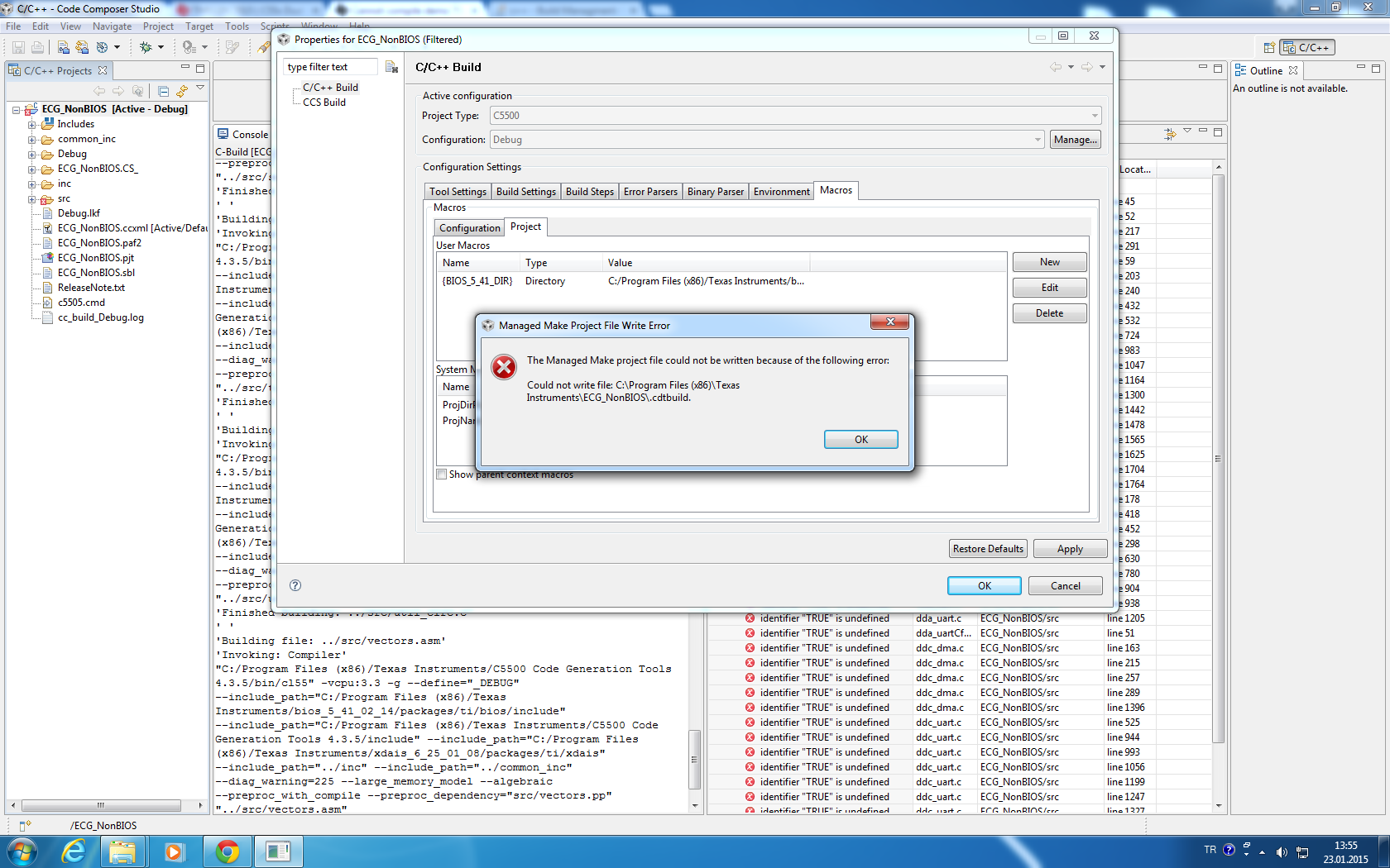

What is the meaning of this error?
Regards.
It is best to stay away from the c:\Program Files(x86) folder both when installing CCS and for your workspace directory, due to UAC (User Access Control) issues with Windows 7. From the screenshot it looks like your project is within this directory. Please use a different location for your workspace.
Also please install CCS to a different location (c:\ti is now the preferred location). More information is in this wiki:
