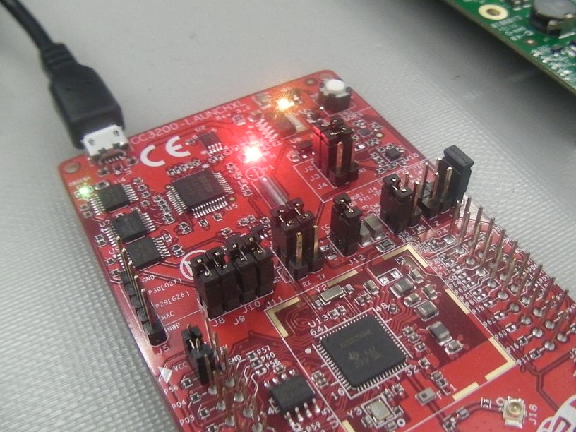

    Sorry about the delay; the file I sent you is based on an internal discussion and was created mainly to overcome a limitation when using XDS200 JTAG debuggers connected to CC3200 devices in SWO mode. However, it also works fine with the Stellaris ICDI connection in several setup systems around here (including mine).
    I have my Launchpad jumpers set to the following:
    Therefore I am unsure what may be going wrong with your setup. For starters I would check the sections General IDE and Debugger of the CCSv6 Troubleshooting page.

  • Hi
    I have just tried the exact same as shown on the pictures above: Using the "Stellaris InCircuit Debug Interface", and the "CC3200SWD" variant. And setting the "Target Connection Option" to SWD, but it doesn't solve the problem.
    When you look at the pictures above, you can also see, that the jumpers J10 and J11 (TDI and TDO) is still in place. This means that the interface is configured for 4W JTAG, while the SOP0 (J17) are configures for SWD. However it seems that the SOP0 pin is only read by the MCU after a total power off. This means that if I try to connect in 4W JTAG (which is succesfull) and afterwards add a jumper in SOP0, I can still connect to the MCU. If I then cycle the power, and try to connect, it is not possible. The conclusion is, that only after power has been switched off and on, the SOP pin is read, and I guess that since it works in the example above, it is because the Launchpad hasn't been disconnected.
    But the problem is more likely to be Code Composer itself...
    If the launchpad is in JTAG mode (no jumpers on any of the SOP pins), it makes no difference if SWD or JTAG is selected in CCS, it can easily connect. But when the Launchpad is in SWD mode, CCS cannot connect neither in SWD nor in JTAG mode. My suspicion is, that SWD/JTAG option does work or simply isn't implementet in CCS, since CCS is in JTAG mode regardless of the setting.
    It could be nice if someone from TI would reproduce to test described above, but this time cycle the power each time the SOP jumpers have been changed.
    /Henrik
  • I had same problems with CCS, but after upgrading to the lastest version released a few days ago (version 6.1.3.00033) it seems that the problem has been solved - it least i works with my CC3200 Launchpad (with the TDI and TDO jumpers removed).
    /Henrik
