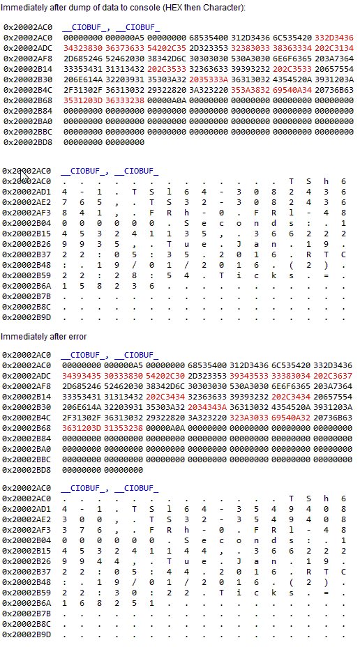

If I disable RTC interrupts in my initialization using MAP_RTC_C_disableInterrupt() then all is well (though of course the functionality related to the RTC interrupts doesn't work).
If I enable RTC interrupts in my initialization MAP_RTC_C_enableInterrupt(), then everything seems to work, except I occassionally get the following message in the console (the xx numbers vary):
"Invalid CIO command (xx) in the CIO buffer at address (xx) was not recognized. Please check the device and program memory maps."
This still happens even if I make the Hwi empty or if I globally disable interrupts (Hwi_disable(), Hwi_restore()) during the Hwi
I'm guessing the RTC interrupt is happening while the micro is dealing with the CIO stuff causing the CIO buffer to be corrupted.
Any suggestions for how to fix this??

    > And if you open a memory window and look at the buffer address “__CIOBUF_” (two leading
    > underscores, and only one trailing), in character format, do you see what looks like it may be
    > an overwrite with a recognizable pattern?
    I hope the following makes sense - I'm having trouble describing it clearly.
    I've tried looking at CIOBUF
    • after a bunch of data is sent to the console (and no error occurs) and
    • immediately after an error (Invalid CIO command (X).....).
    I look at the good data first and the "bad" data second.
    The two memory dumps are "identical".  Of course, the specific time text changes between the dumps, but all the other hex stuff around that text (which I guess is framing for the message) stays the same.
    Most critically, the error gives a command number - e.g. "Invalid CIO command (165) in the CIO buffer at address (0x20002AC0) was not recognized.".
    I see that exact command number (165 or 0xA5 in this particular case) at address 0x20002AC4 (second word of __CIOBUF_) in BOTH the good and the bad case.  (The images below show the memory contents.)
    So for some reason, I'm getting "Invalid CIO command errors" even though the contents of __CIOBUF_ has not materially changed.   There does not appear to be a CRC in this data that might account for this.
    Cheers
    Julian

    Invalid CIO command (26) in the CIO buffer at address (0x200028C0) was not recognized. Please check the device and program memory maps.

    2) On-board XDS110 set to "SWD Mode - Aux COM port is target TDO" pin with Interrupt Profiling Hardware Trace Analyzer running, got 32 errors and 62 expected strings:

    3) Using an external Segger J-Link set to SWD, got no errors and 262 expected strings:

    [CCS 6.1 doesn't support hardware trace with a Segger J-Link, so no results for Segger J-Link with hardware trace analyzer enabled]
    The conclusion is that the problem appears to be in the emulation side rather than the MSP432 target, since:
    a) See the problem when using a XDS110, but not when using a Segger J-Link.
    b) When using the XDS110 enabling the Interrupt Profiling Hardware Trace Analyzer makes the problem occur more often. Enabling Interrupt Profiling means the XDS110 is having to pass SWO messages to the CCS debugger, and so if the problem is timing relating maybe the handling of the SWO messages causes the problem to occur more often.
  • Julian Kolodko said:
    I've cut down the application to the simplest example that still has the error.  The resulting project is attached as a zip file.
    I have created a simpler example of that, by using the MSP432 DriverLib  2_20_00_08 to create a non TI-RTOS example which has a RTC interrupt and main() calling printf() in a delay loop. This non TI-RTOS example only has the RTC interrupt active, whereas the TI-RTOS example also had timer interrupts.
    The non TI-RTOS example shows the same symptoms as the TI-RTOS example in that:
    a) Get "Invalid CIO command (34) in the CIO buffer at address (0x20000818) was not recognized" errors when using the MSP432 on-board XDS110 emulator, with a higher error rate when the Interrupt Profiler Hardware Analyzer is used.
    Example CCS CIO output when used the on-board XDS110 with Interrupt Profiler enabled:

  • G'Day Chester,
    Thanks for your detailed look into this!
    I've tried the built in XDS110 and my external XDS200 and get the error with both.
    The numbers I see vary all over the place.
    So it looks like there is a real problem, that appears to be related to a bad interaction between the RTC interrupts and the emulator.
    What is the next step from here?
    Cheers
    Julian
    At the moment don't understand exactly what is causing the problem. Maybe if you enable Debug Server Logging and post the log file for a debugging session which has the invalid CIO command errors that will give more clues.
