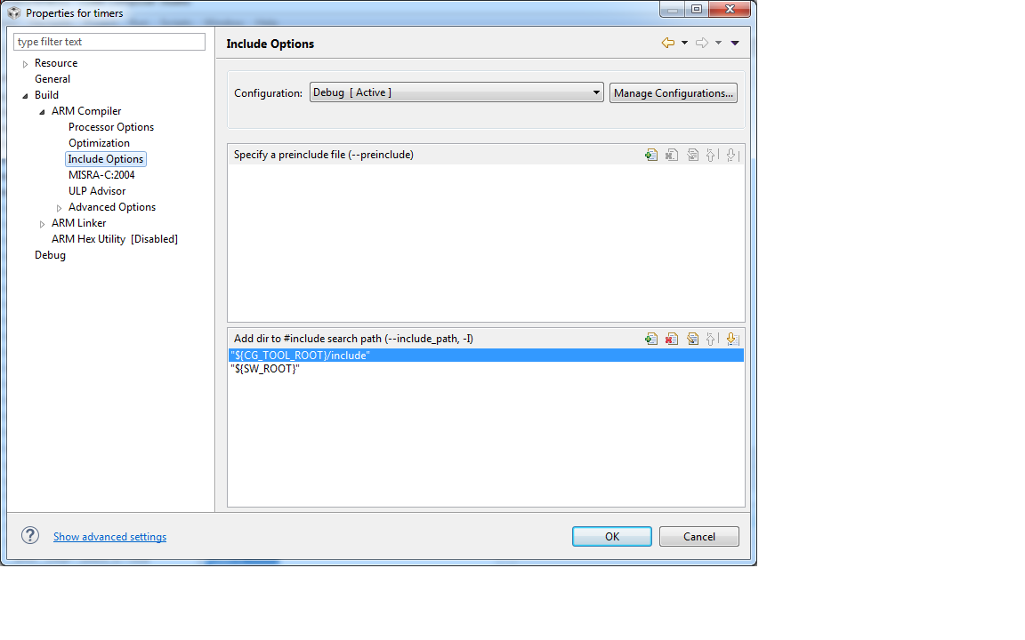

  • Thanks for your suggestions, ki. Your first suggestion in the include options was already there. I did, though, add ORIGINAL_PROJECT_ROOT as you show. I found that the value automatically appeared, though I did have to change the type from path to directory. Unfortunately, the compilation problem persists. The error message is identical as before implementing your suggestions.
  • Did you import the project into your workspace folder or did you leave the project in its original location?
    If ORIGINAL_PROJECT_ROOT is set correctly and SW_ROOT ends up correctly pointing to the root TivaWare directory, then it should find that header file. Can you copy and paste your entire build output to this thread?
  • I did import the project into my workspace folder. It is here: C:\Users\Otto\workspace_v6_1_3\timers. Here is the build output:

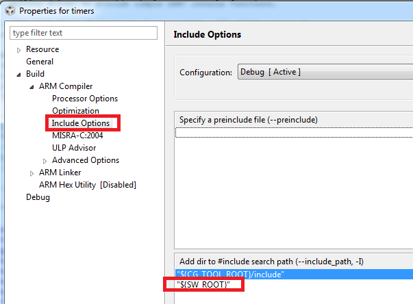

  • This is the problem (bolded in red):
    Otto Hunt said:
    'Invoking: ARM Compiler' "C:/ti/ccsv6/tools/compiler/ti-cgt-arm_15.12.1.LTS/bin/armcl" -mv7M4 --code_state=16 --float_support=FPv4SPD16 -me -O2 --include_path="C:/ti/ccsv6/tools/compiler/ti-cgt-arm_15.12.1.LTS/include" --include_path="C:/" --advice:power=all -g --gcc --define=ccs="ccs" --define=PART_TM4C1294NCPDT --define=TARGET_IS_TM4C129_RA0 --diag_wrap=off --diag_warning=225 --display_error_number --gen_func_subsections=on --abi=eabi --ual --preproc_with_compile --preproc_dependency="startup_ccs.d" "../startup_ccs.c"
    It should be pointing to:
    --include_path"C:/ti/TivaWare_C_Series-2.1.2.111"
    You can manually modify your include search path to add this. But I wonder why it is not setting it up correctly by default. Can you provide the same screenshots of your include search paths and build variable definitions that I showed in one of my previous posts?

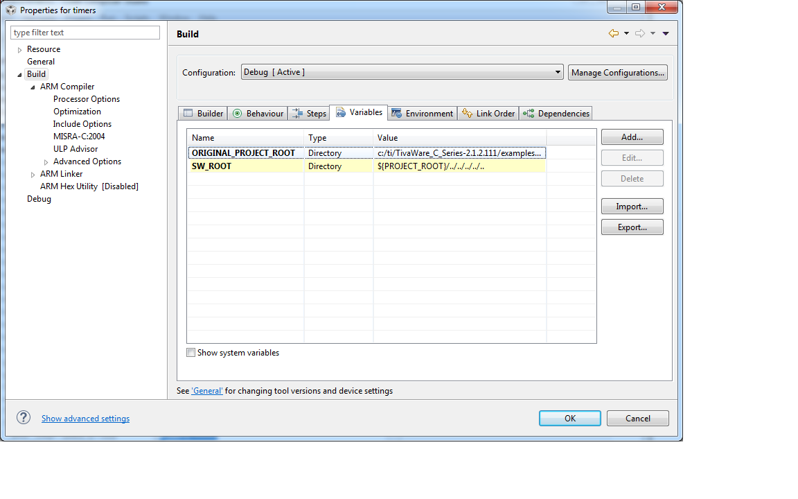

  • Per your request here is screenshots of the search paths and build variable definitions:
  • What is ORIGINAL_PROJECT_ROOT set to? In the screenshot, it is truncated.

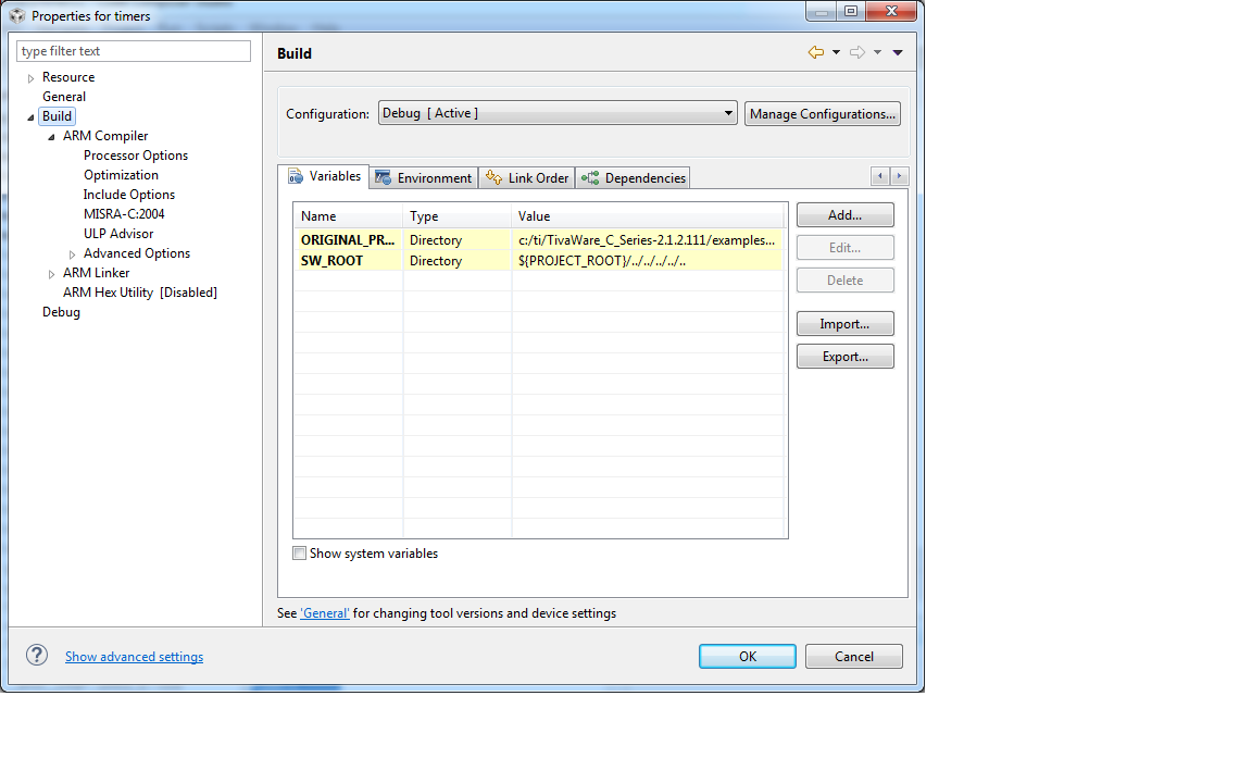

  • Here is a better screenshot of the build variables:

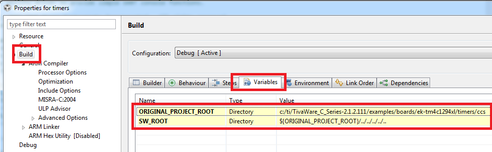

  • I was going to reply that I can't make out the full value of the variable (for example, mine is set to: c:/ti/TivaWare_C_Series-2.1.2.111/examples/boards/ek-tm4c1294xl/timers/ccs)
    However, by looking at your screenshot again, I think I see the issue. In your settings, SW_ROOT uses ${PROJECT_ROOT}, when it should be using ${ORIGINAL_PROJECT_ROOT} like what is shown in my screenshot. Please modify SW_ROOT accordingly.
    The other question is why it is using PROJECT_ROOT in the first place. Did you import via "Project->Import Projects" option?
  • Changing ${PROJECT_ROOT to ${ORIGINAL_PROJECT_ROOT} per your suggestion reduced the error count to two. I also added the include path you suggested earlier (--include_path"C:/ti/TivaWare_C_Series-2.1.2.111") but it did not appear to make an additional difference. Here is the new error listing:

    I did import the timer example project into my workspace. Here is a screenshot of the workspace directory:
  • The remaining error is:
    gmake:*** No rule to make target
    I could find no useful information on this error in this forum. So I finally deleted the timer example from my workspace, then re-imported the same. Now it compiles fine, no errors. This time the build variables, etc, were correct - I did not have to putz with any settings. Weird. Anyway, I'm a happy camper now. Thanks for your help, ki!
  • Ok, glad to hear the re-import resolved the issue. Basically what seemed to have happened is that either the initial import for the first project did not succeed successfully or that the project got corrupted somehow because both your linked resource path variable and build variables were invalid. This is the reason for all your issues. We resolved the latter (fixed the SW_ROOT build variable) but not the former (the SW_ROOT linked resource path variable was pointing to the wrong location and uartstudio.c is a linked source file reliant on the SW_ROOT linked resource path variable). Fixing that path variable would have resolved the next error you got.
    In any case, looks like when you deleted the corrupted project and reimported it, the project had the variables configured correctly this time.
