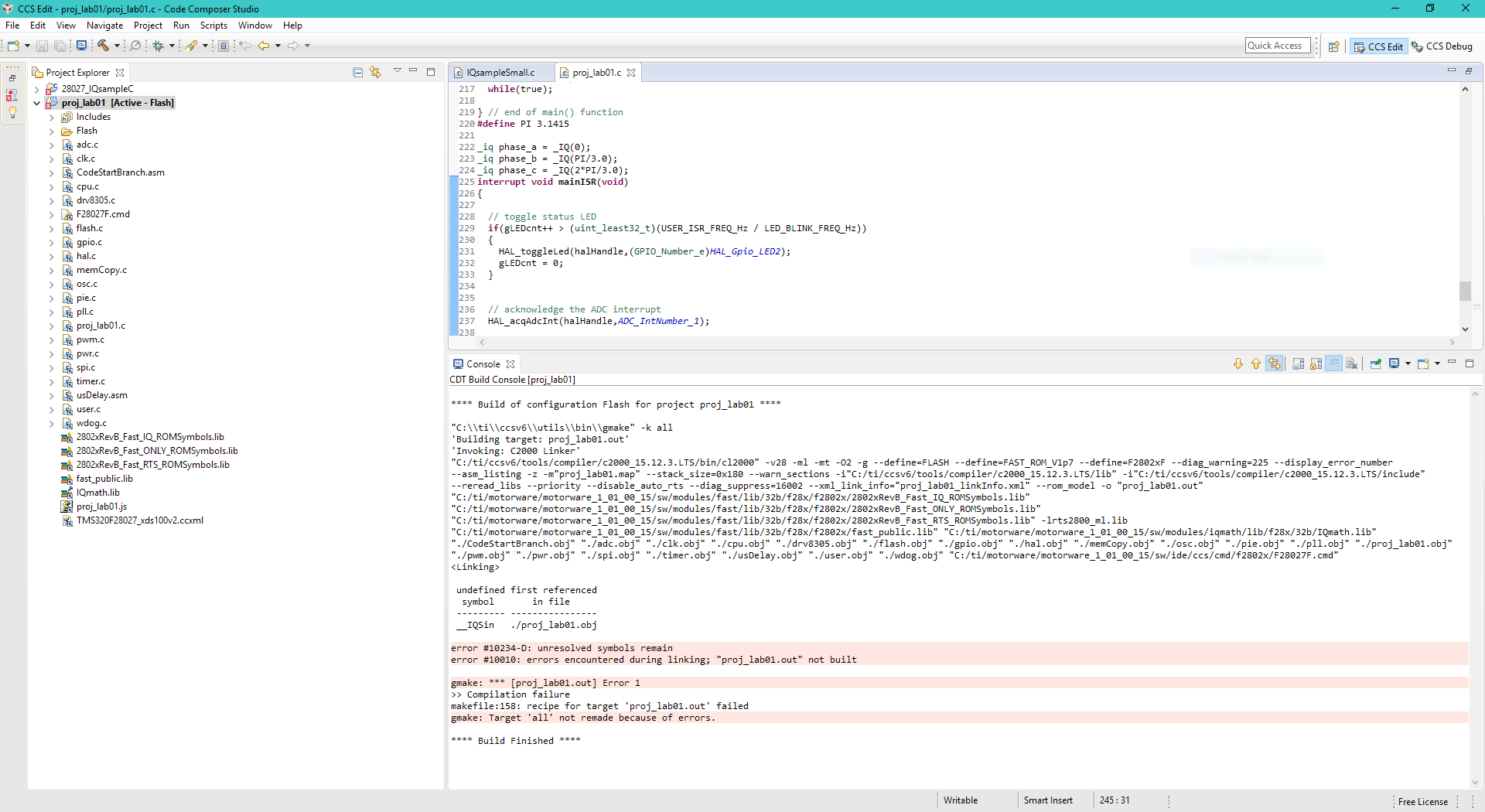

I'm attempting to modify a MotorWare example project (project 01 for the boostxl_drv8305 and F28027x C2000 chip) to output sinusoidal PWM signals.
In doing so, I've used the IQMath library and I believe that I have successfully included the library file (already included in example project) as well as the correct header file to access the IQMath lib functions.
I've had a look at the IQMathLib.h header I am including and it contains a definition for the _IQSin() I am trying to use, but I get the following build error:

As can be seen, the IQmath.lib file for this CPU is in the linker's path.
The following shows the warning during compilation of my code:
'Building file: C:/ti/motorware/motorware_1_01_00_15/sw/solutions/instaspin_foc/src/proj_lab01.c'
'Invoking: C2000 Compiler'
"C:/ti/ccsv6/tools/compiler/c2000_15.12.3.LTS/bin/cl2000" -v28 -ml -mt -O2 --include_path="C:/ti/motorware/motorware_1_01_00_15/sw/modules/hal/boards/boostxldrv8305_revA/f28x/f2802x/src/" --include_path="C:/ti/ccsv6/tools/compiler/c2000_15.12.3.LTS/include" --include_path="C:/ti/motorware/motorware_1_01_00_15/sw/solutions/instaspin_foc/boards/boostxldrv8305_revA/f28x/f2802xF/src" --include_path="C:/ti/motorware/motorware_1_01_00_15/sw/modules/iqmath/src/32b/" --include_path="C:/ti/motorware/motorware_1_01_00_15" -g --define=FLASH --define=FAST_ROM_V1p7 --define=F2802xF --diag_warning=225 --display_error_number --asm_listing --preproc_with_compile --preproc_dependency="proj_lab01.d" "C:/ti/motorware/motorware_1_01_00_15/sw/solutions/instaspin_foc/src/proj_lab01.c"
"C:/ti/motorware/motorware_1_01_00_15/sw/solutions/instaspin_foc/src/proj_lab01.c", line 245: warning #225-D: function "_IQSin" declared implicitly
'Finished building: C:/ti/motorware/motorware_1_01_00_15/sw/solutions/instaspin_foc/src/proj_lab01.c'
I get an error about an implicit declaration, despite the declaration being present (or at least redefined to _IQ30SIN() and then that is defined extern) in the IQMath header in C:/ti/motorware/motorware_1_01_00_15/sw/modules/iqmath/src/32b/ (I use #include "sw/modules/iqmath/src/32b/IQmathLib.h" for good measure).

What's going on here? I'm certain I'm doing something stupid, so I've attached a screenshot of my work environment in CCS as well as a zip of the project.
