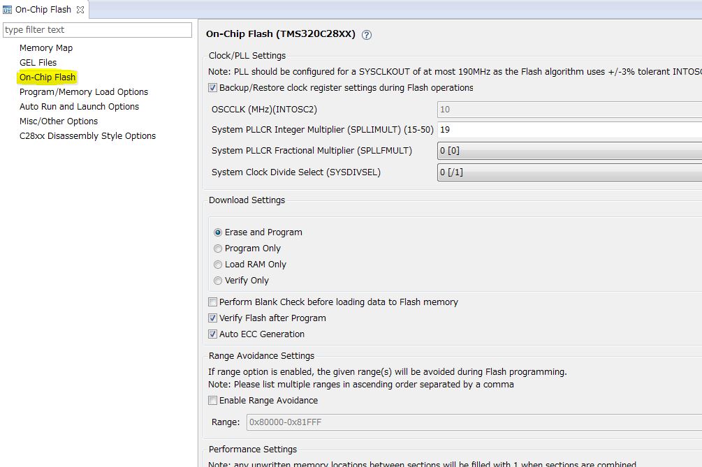

Hi everyone,
I'd like to calculate checksum for F2837xS device.
I opened the On-chip Flash window with CCSv, 6.2, but there was no item to calculate the checksum.
Incidentally there are items to calculate the checksum in F2802x,F2803x, etc...
Sasaki
  • Sasaki,
    As you noted, the checksum calculation feature is only available on the older C2000 family of devices like F2802x,F2803x, but is currently not available on the newer family of devices like the F2837xS that you are using.
    We are currently in the process of evaluating adding the checksum calculation feature to the newer family of devices, but we do not have a schedule on this process at this point.
    In the mean time, you can use the standalone full verification step to verify that the flash was programmed correctly.
    Ricky
  • Ricky-san,
    Thank you for your answer.
    I will request my customer to verify flash.
    Sasaki
