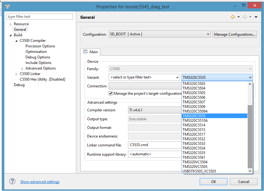

    Sounds like you when you installed CCS, you chose a "custom" install and did not choose the components needed for C55x support. Try rerunning the installer exe again and choose the existing CCSv6 directory. The installer will then detect an existing install of CCS and allow you to add components.
    The other option is to take the opportunity to install the latest CCSv6 version (6.2.0) in a new clean directory.
    ki
        Already i install C5000 but this device only not having in selection list as below.still you want to reinstall CCS C5000
  • Thanks for the screenshot. I can see you do indeed have C5000 support installed. But I can also see that your version of CCS does not support C5545. I confirmed that your version of CCS (v6.1.0) is too old and doesn't have support for the C5545. Please update your CCS version. As mentioned in my earlier post, CCSv6.2.0 is the latest version and I recommend you install that version.
