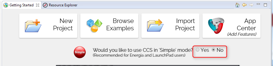

  • Michael,
    The perspective switch should be fast.  One thing we could try is to disable the switch.  There are a couple ways to do this is to enable Simple mode.  Go to the View menu and select Getting Started.   There is a selection to enable Simple Mode.
    Mostly what this does is open a simplified perspective that is used for both Editing and Debugging.  Thus there will be no perspective switch.  I am curious to see if it makes a difference.
    John
  • Hi John,
    I found an update for CCS (7.1.0.00016) on the wiki (even though CCS's update manager said no updates available) and disabled perspective switch (I told it to stay in debug perspective all the time) and now my time from F11 to seeing code output is down to 45-50s which is a significant improvement but still slower than I'd like.

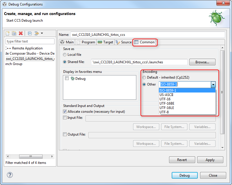

  • Michael,
    I remember looking into this once a few years ago.
    Try going to the little down arrow beside the Bug button.  Select Debug Configurations.  Select your Debug Configuration on the left (typically your project name).  Then click on the "Common" tab.  There are options there for the encoding.  I believe this impacts the console.
    Give that a try and let me know if it does the trick.
    John
  • It's already set to UTF8 - in fact it's set to "Default - inherited (UTF8)" as I've set the top-level CCS setting to UTF8

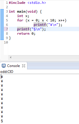

    I realized we never closed off on this.  I did a little test with a normal printf today and that works fine with UTF8 characters:
    Since the console can handle this ok I believe your earlier thought about it being a limitation in system_printf is likely bang on.  I have asked someone to confirm.  The system_printf is a subset of printf for size/performance reasons.

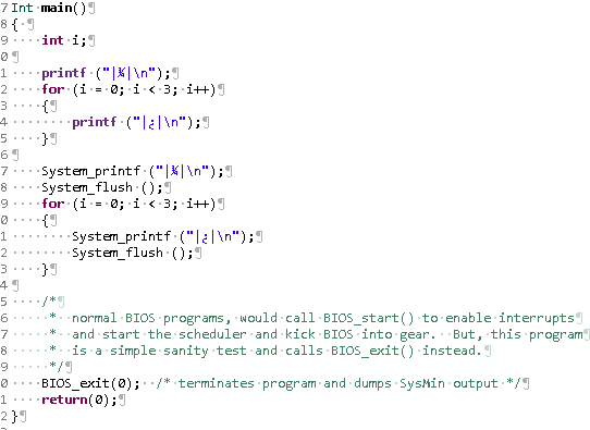

    I created a test case which passed UTF8 characters to both print() and System_printf() in a SYS/BIOS program for a Cortex-M4F (TM4C1294NCDPT). The program was:
    Where the two strings use the UTF8 characters as described by UTF-8 encoding table and Unicode characters as:
    - "VERTICAL LINE" "VULGAR FRACTION THREE QUARTERS" "VERTICAL LINE" "newline"
    - "VERTICAL LINE" "INVERTED QUESTION MARK" "VERTICAL LINE" "newline"
    The encoding for the source file and debug configuration was set to UTF8.
    The CCS 7.1.0.00016 CIO console output was:
    The CIO console output shows the same output from both printf() and System_printf(). The problem is that a spurious "LATIN CAPITAL LETTER A WITH CIRCUMFLEX" UTF8 character is displayed as the 2nd character in the output in the CIO console.
    Inspecting the assembler listing from the compiler showed the expected UTF8 characters had been encoded.
    A breakpoint was set on the xdc_runtime_SysMin_output__I function which is the SYS/BIOS function which is called to pass the formated string to the HOSTwrite function used to pass CIO output to the CCS debugger. The buffer contained the expected UTF8 characters. Stepping through the xdc_runtime_SysMin_output__I function function showed the expected UTF8 characters written to the __CIOBUF_ array which is where the CCS debugger reads the data to be displayed in the CIO console. Therefore, in my test case I can't see any error in how the target is handling UTF8 strings, and so the spurious "LATIN CAPITAL LETTER A WITH CIRCUMFLEX" UTF8 character which appears in the CIO console must be a problem in CCS debugger end.
