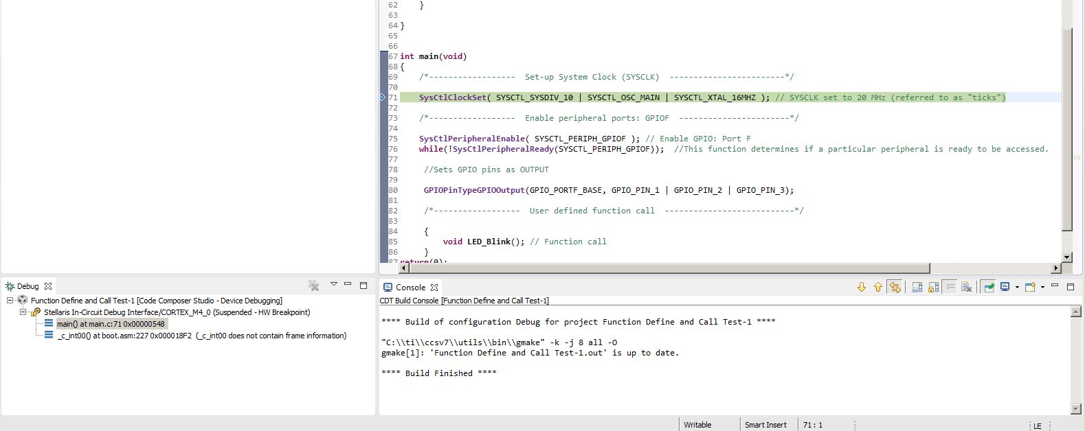

  • Hi Chester,
    Good news and bad news!
    Good: I made the changes as you described, and the code did compile; no errors, the code builds.
    Bad: The target does not load and/or the code.
    Below are the Console and Debug window captures; they change with each successive click of the green Resume button as follows.
    Note that the Debug window information changes. There also appears to be a break-point being set.
    Also, I have included a copy of the modified code at the end of this post.
    I really appreciate your help.
    Thanks again, Bob
    1. Before clicking Green resume button:
    2. After FIRST click of  Green resume button:
    3. After SECOND click of  Green resume button:
    4. The newly modified code:

  • Robert Samuel said:
    /*------------------ User defined function call ---------------------------*/ { void LED_Blink(); // Function call }
    The main() function only makes a single call to the LED_Blink() function and then the main function returns. When the main function returns the program will end in an infinite loop in the loader_exit() function which explains your observed behaviour when using the Resume button in the debugger.
    An embedded program should usually run for ever. For your example of a blinking LED program the main function should call the LED_Blink function continuously in a loop. E.g. try:
         while (1)
    		 while(1)
     return(0); // THE WARNING MESSAGE NOTED ABOVE IS IN THE CODE'S MARGIN AND NOT CAPTURED

    I have run that code on a EK-TM4C123GXL and can repeat the problem of the LED not flashing when compiled with the TI ARM compiler.
    Realised that the problem is that in the function call the void qualifier is causing the compiler to eliminate the function call:
         while(1)
    To fix this, change the code to remove the void qualifier (I missed this when I suggested my previous code change to add the while loop). I.e. change the function call to:
         while(1)
    With that change the program blinked the tri-color LED on the launchpad.
