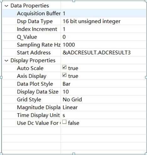

 I use a waveform generator to give a sine to ADC as below. Max value is 1.2V, min value is 0V, frequency is 1 Hz.
Configure CCS graph as below. Sample rate is 1000Hz.
In CCS graph, it is something as below. The shape is right, but the period is 0.012s. It should be 1s.
The time between 2 graph sample Point is 0.001s, which is correct.
Could you kinldy help me on this issue?
  • I am very sorry, I post a wrong picture for CCS graph configuration. It is as above. Sample rate is 1000HZ.

  • Hello Dear Rafael:
    1. Thanks very much for your quick feedback. But i think it is not my problem. I configure the sample rate is 1KHZ. And you can see the time between 2 sample points is 0.001s, which is correct. But the period is 0.012s, which should be 1s. In DVT-1935, it says that
    When creating a graph, setting the option "Sampling Rate Hz" does not seem to take effect on the displayed data - more specifically on the X axis.
    According to its documentation, this option should scale the X axis by dividing the "Display Data Size" per the "Sampling Rate Hz".
    2. And when i give a 16KHZ sine to ADC, I configure the sample rate as 1000000.But i have a really bad graph in CCS. If CCS graph can show a sine waveform of 16KHZ.
    Please apologize for the delay. Are you still having this issue? A few comments about your last reply.
    1. You are correct that DVT-1935 is not really related to this issue. However, I think the graphs are correct. From your last picture I can count about 6 samples on the half cycle of the sinewave. Given each sample is represented as happening at every 0.001s, an entire cycle will be comprised of about 12 samples or 0.012s.
    2. When you increase the sinewave frequency on the ADC input, the CCS IDE can't update the graph fast enough to keep up with the reading rate of 1/16k samples, thus missing several samples and therefore representing a heavily distorted sinewave.
    In this case, you will forcefully need to create a buffer array that holds one or a few periods of the sinewave and then configure your graph to point to its starting address, set the Acquisition Buffer and Display Data Size to match your buffer size and set a breakpoint that updates the graph at the end of each filled buffer. Some details can be seen in the pages below:
    processors.wiki.ti.com/.../Graph_Visualization_for_MSP430
    Section 3.5 of:
    processors.wiki.ti.com/.../GSG:Debugging_projects_v5
    Hope this helps,
    Rafael
