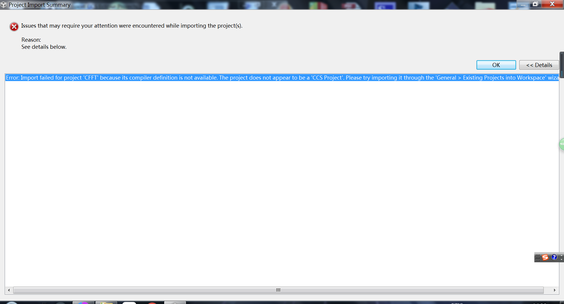

After creating a new workspace and importing the Example project 'CFFT' from DSPLIB, an error displayed:

The error message in the title of this thread is different from the message in the screenshot you posted. So which error exactly are you seeing?
Which version of CCS are you using to import the project? And are you importing the project using the menu item Project->Import CCS Projects?

The CCS I used is Version V6. The operations are as below:
File--Import--General--Existing Projects into workspace--C55_DSPLIB_03.00.00.03--Examples--CFFT
The error massage:
user5152206 said:File--Import--General--Existing Projects into workspace--C55_DSPLIB_03.00.00.03--Examples--CFFT
This is not the correct way to import a CCS project. You should use "Projects -> Import CCS Projects"
Then in the import wizard, set the search directory to the path of the location of the desired CCS project
And the select the project in the "Discovered projects" list and make sure the "Copy project into workspace" is DISABLED. Then press "Finish" to import it.
It will then appear in the Project Explorer
Note that this project seems to have a dependency on the dsplib project. So I needed to import that one also (located in .\c55_dsplib_03.00.00.03\build\ccsv5). Again, follow the same steps as for the other project (make sure project is NOT copied into the workspace)
then for the cfft project, go to the project properties and DISABLE the XDAIS property as shown below:
Then you can build the cfft project. This will build the dependent dsplib project and then the cfft project.
That should be it. This worked for me in CCSv6.2
