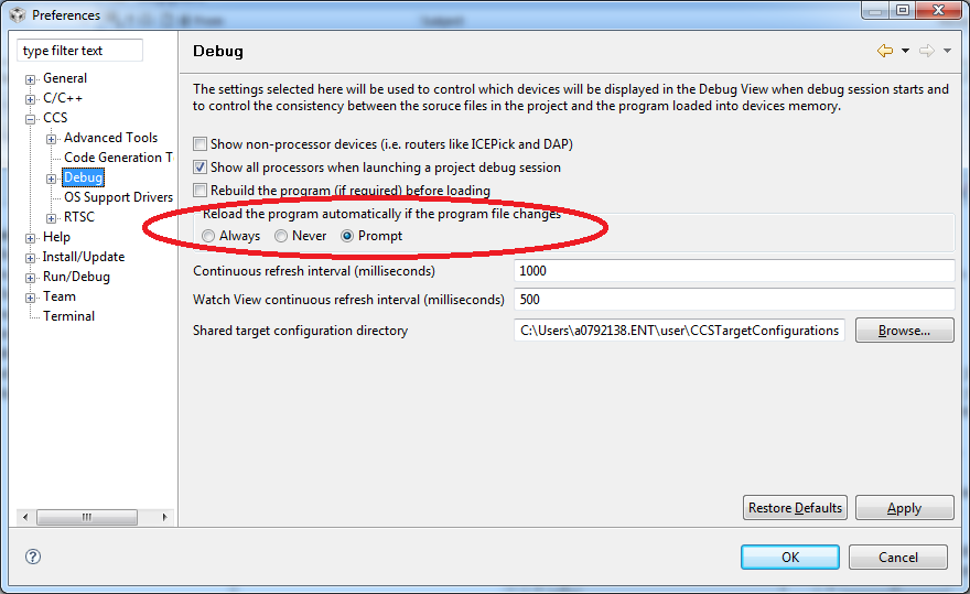

Ever since I did a recent minor upgrade of CC I see annoying behavior with building/debugging.  In Debug mode, when I do a build, it now takes the liberty of running debug.  This takes over 40 seconds for just 1K bytes of obj code so I'd like to avoid doing debug runs when I just need to do a basic compilation.  I couldn't find a CC or compiler switch to prevent this.

    It sounds like you are doing a "Debug Active Project". That will do a build, and then start a debug session. You should just do a "Build Active Project"

  • Thanks, for the info, Ki, I appreciate it.  I'm not sure if you understood what I was saying.  Once again, when I say either "Build Active Project" or "Rebuild Active Project", either from the pull-down menus or using the buttons, the tool does a build AND THEN does a debug.  By "debug" I mean it does the same things it would do if I manually said "Debug" and results in the console message "MSP430: Program Loaded..." and the cursor is placed at the start of main.c in debug mode.  This process wastes 30 sec of my time.  I do not want the tool to do a debug when I tell it to do a build.  Can anyone tell me how to configure it accordingly?  Thanks.

    If you do a build during a debug session CCS will detect that the program you are debugging has changed.  I don't have access to CCS at the moment but I believe the first time this happens it will prompt you if you want to reload the program and then after that it remembers your decision.  You can change this option.  I think it is Windows->Preferences.  Click on CCS and then Debug and there should be an option that says something about reloading the program automatically when it changes and it should have 3 settings; always, never and prompt (or something similar).

  • Here is the option:
  • Thanks, John,  This indeed provides some control of the behavior but it doesn't solve the main problems.  First, that when it reloads it typically creates a new, redundant tab for an existing file (ie, now there will be two tabs for the same file).  This can cause loss of data, especially when I don't realize there are two and make different edits to each one.  Secondly, when I do a debug it sometimes deletes one or both tabs so I have to go into the Projects view and re-load the .c file again. Third, when I simply try to do a build it does both a build and a full debug operation (time consuming).
