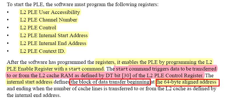

  • Hi, experts:
    According to a8 spec ver. r3p2,  it indicates that the start address requires 64 bits alignment. How
    could you align the virtual address of an array that was assigned by the OS at the first place?
    If I prepare another buffer address that is 64 bit aligned, doesn't it means to take extra CPU clocks to move data back and forth? Could someone provide a better solution for the alignment issue?

  • Joey,
    I see this text is extracted from the ARM TRM:
    http://infocenter.arm.com/help/topic/com.arm.doc.ddi0344k/DDI0344K_cortex_a8_r3p2_trm.pdf
    8.4.1 Configuring the preload engine
    Thus the right place to ask about this text is the ARM forum.
    I can also provide you an example for programming the Cortex-A8 ARM for the OMAP3 device, but should be similar to the Cortex-A8 ARM for the DM814x device:
    http://e2e.ti.com/support/dsp/davinci_digital_media_processors/f/716/p/341640/1193445.aspx#1193445
    Pavel
