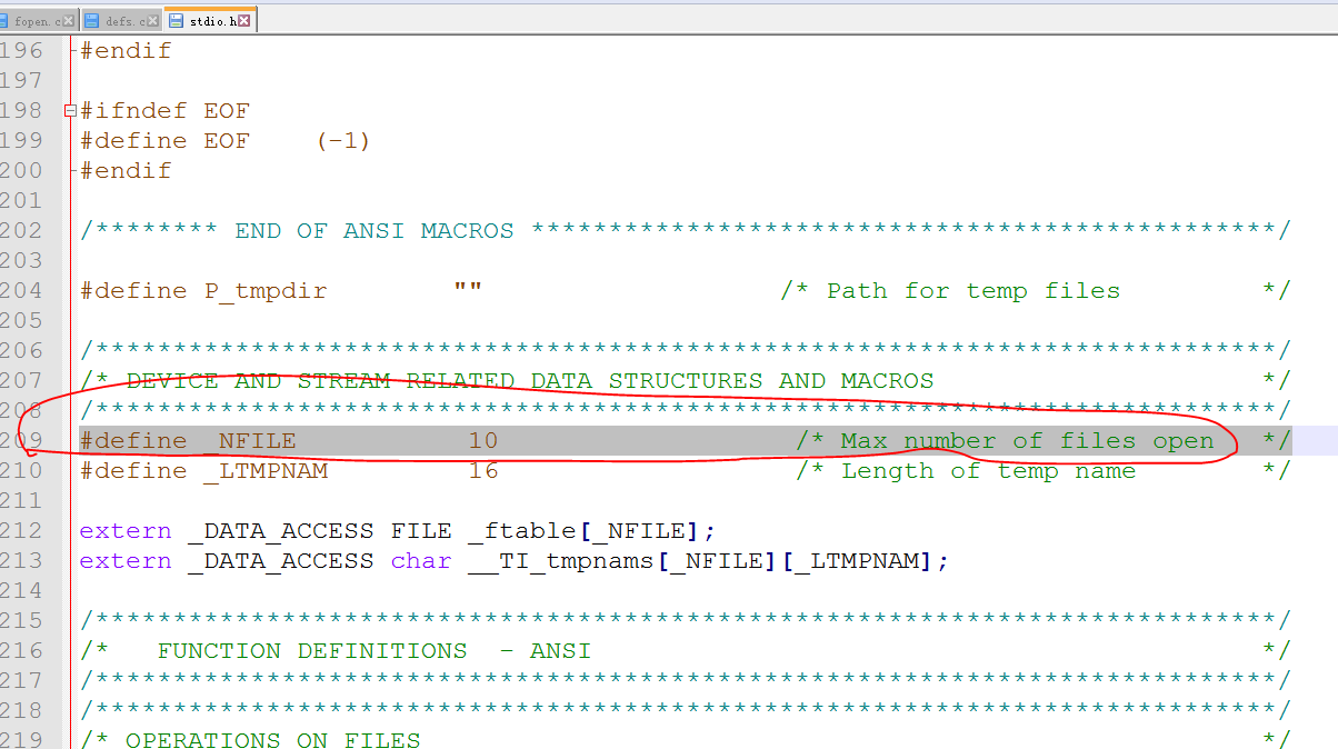

I want to modify the _NFILE (10) macro in the stdio.h.
how to do it simplely?

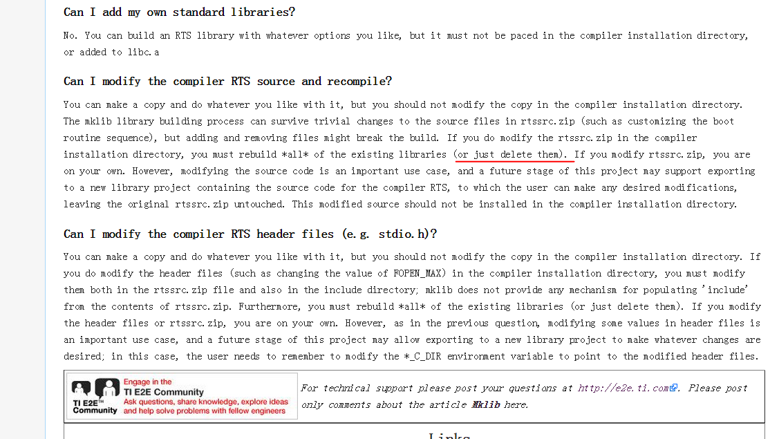

Is it possible to just remove the used library in the "ccsv6\tools\compiler\ti-cgt-arm_5.2.7\lib" and rebuild my project?
The ARM compiler manual discusses your situation. Please see the section titled Allowable Number of Open Files.
