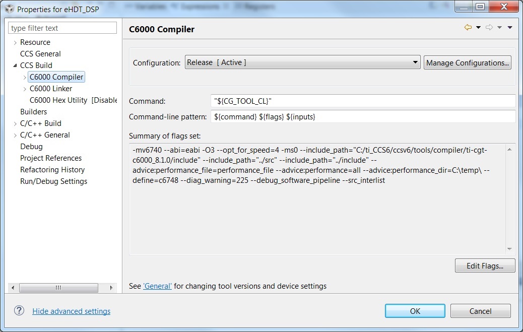

  • The build options you show in the screen shot and those you show from the automatically generated performance information file ...
    Rong Wang2 said:
    ;* User Options: --abi=coffabi --opt_for_space=2 --opt_for_speed=5 --opt_level=3 --preproc_macros=C:/eHDT_wk_bin_4/.metadata/.plugins/org.eclipse.core.resources/.projects/eHDT_DSP/com.ti.ccstudio.project.core/Release/symbols.txt --silicon_version=6740 --symdebug:dwarf
    ... do not match.  Note that --symdebug:dwarf is the same as using -g.  I'm not sure how this mismatch occurs.  Are you looking at the correct performance file?  According to the build options in the screen shot, the performance file from this build is C:\temp\performance_file (no extension).

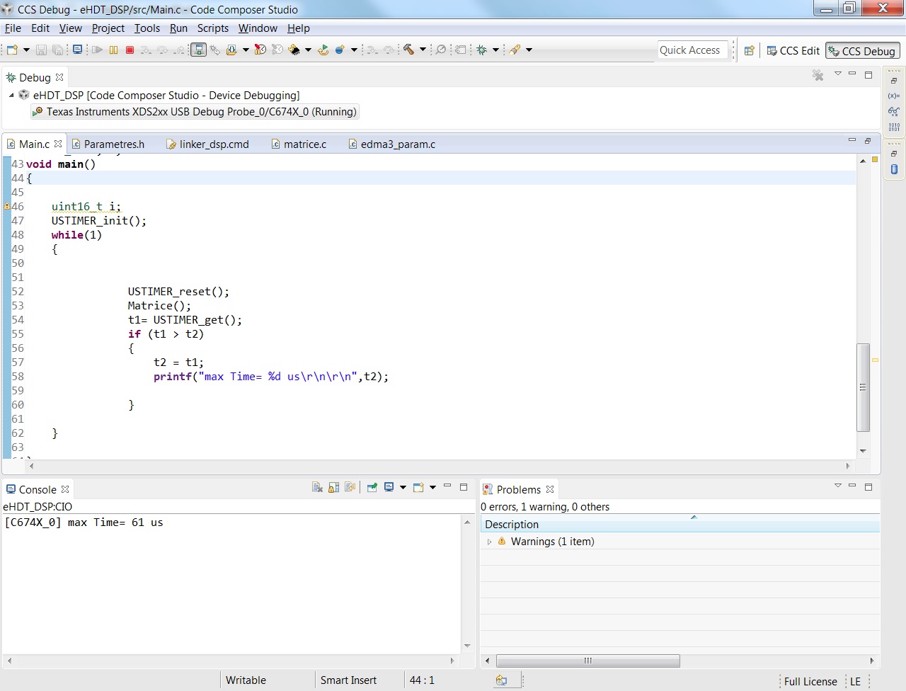

  • Thank you very much for your help!.
    sorry, I copied wrong performance file. here are the new one. It looks the -g is gone, but the performance is still not improved.
    I just have a simple loop funciton as below. but the execution time is about 40 micro seconds. I tried to set optimication in CCS and it did not work when it is Debug mode. after I changed to Release mode, then it worked, the execution time was reduced to 2 micro seconds. but after I add more code in my project and did not change optimization, I fund the execution time for this function back to 40 micro seconds again. I did not any anything on this funciton. following is the function code, and CCS setting.  attached is performation file. what could prevent optimication working?
    To know whether the assembly code I generate has the same performance as this ... Please build this way again, but add the options --debug_software_pipeline and --src_interlist.  These options tell the compiler to not delete the generated assembly file, add yet more information to the comment block inserted before every software pipelined loop, and add comments that aid in understanding the assembly code.  Then attach that assembly file to your next post.  Add the file extension .txt to it, so the forum does not reject it.  To better understand those options, please look them up in the C6000 compiler manual.

    7673.matrice.txt
    include <string.h>
    #include <stdio.h>
    #include "types.h"
    int32_t matrice_data_input[22];
    int32_t matrice_data_output[14];
    uint16_t MatriceInterne[14][22];
    void Matrice(void)
        uint16_t i,k;
        int32_t accumulator;
        #pragma MUST_ITERATE(1,14 , 1)
      for(i=0;i<14;i++)
            accumulator=0;
          #pragma MUST_ITERATE(1,21 , 1)
          for(k=0;k<22;k++)
                if(MatriceInterne[i][k]==1)
                    accumulator += matrice_data_input[k];
            matrice_data_output[i]= accumulator;
  • I apologize for the delay.
    Thank you for submitting the files.  When I build your matrice.c with the options you show for your Release configuration, I get assembly output that is the same as I see in your matrice.asm.  (To be precise, it does not match.  But I can tell it will take the same number of cycles.)  I presume this is the assembly code which runs very fast, about 2 micro seconds.
    So I still have not reproduced the poor performing code you first complain about.  Please show, by copy-n-paste, the exact build options the compiler sees when you the code runs slower, about 40 micro seconds.
    Thanks and regards,
    -George
  • Hi George,
    thanks for your reply. the screen shot I sent you is the exact configuration, and the second image shows the executime is 61us.
    sorry, I forgot to mention that my code is running on DDR2. attached is my link cmd file.
    ron

  • I'm not certain, but I suspect you have not enabled the cache.  I do not have enough knowledge of cache to be a reliable guide.  I suggest you start a new thread in the C67x device forum.  Or, if you prefer, I can move this thread to that forum.
    Thanks and regards,
    -George
