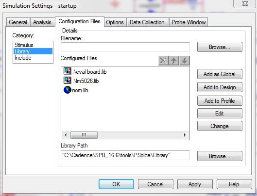

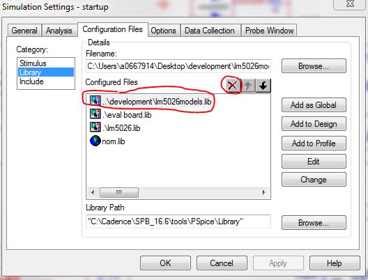

I tried to simulate the LM5026 with ORCAD 16.5. I have some errors for the simulation: ".LIB "D:/LM5026/development/lm5026models.lib"
ERROR(ORPSIM-16276): Can't find library"
In theZIP, lm5026models.lib doesn't exist and the folder "development" is not create.
Anyone know how to solve this problem?
