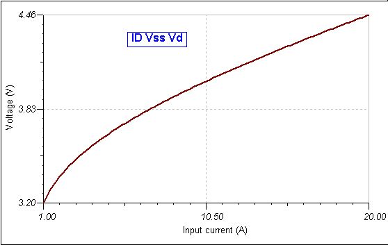

    .subckt PT_121 A K
    DLED A K PT_121_B
    .model PT_121_B D(Is=4.352e-7 Rs=.032 N=8.37 Cjo=5n Xti=100 Iave=20A Vpk=5.3 )
    .ENDS PT_121
    Suresh

    Please find the attached .TSM file (LED.TSM), you can directly place this part in your design.
    Also attaching ID vss Vd graph obtain using model, it might help you.
    To answer your questions:
    1. You are correct A & K are LED two nodes
    2. The line DLED A K PT_121 says it is diode, whose model is defined as PT_121 ( if you want to use the default diode model replace PT_121 with D )
    3. .model PT_121 is the model definitions for the LED
    4846.LED.TSM
