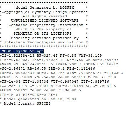

I want to simulate a circuit with this bjt: http://www.onsemi.com/PowerSolutions/supportDoc.do?type=models&rpn=MJE3055T
So I've taken the Spice3 model they provide:
And turned it into this
It doesn't work, cannot import. Can someone advise on the right syntax, please?.
Many thanks!
  • Jorge,

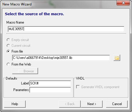

    You do not need to use the .SUBCKT format. TINA-TI will import the .MODEL correctly, however, you have to know what to expect when importing the model file. Simply save the model into a .lib file. In this case, I used MJE3055T.lib. Use the New Macro Wizard to import the .lib file.

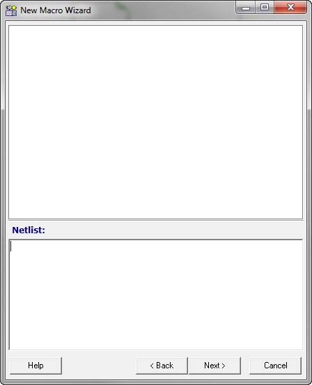

    Click on Next after you have chosen the file. You will notice that the window that comes up is blank.
    Click on Next and choose where to save the macro. TINA will then ask you to place the device in your schematic. You may place it or load it from the macro you created. When you open the macro, it will look different:
