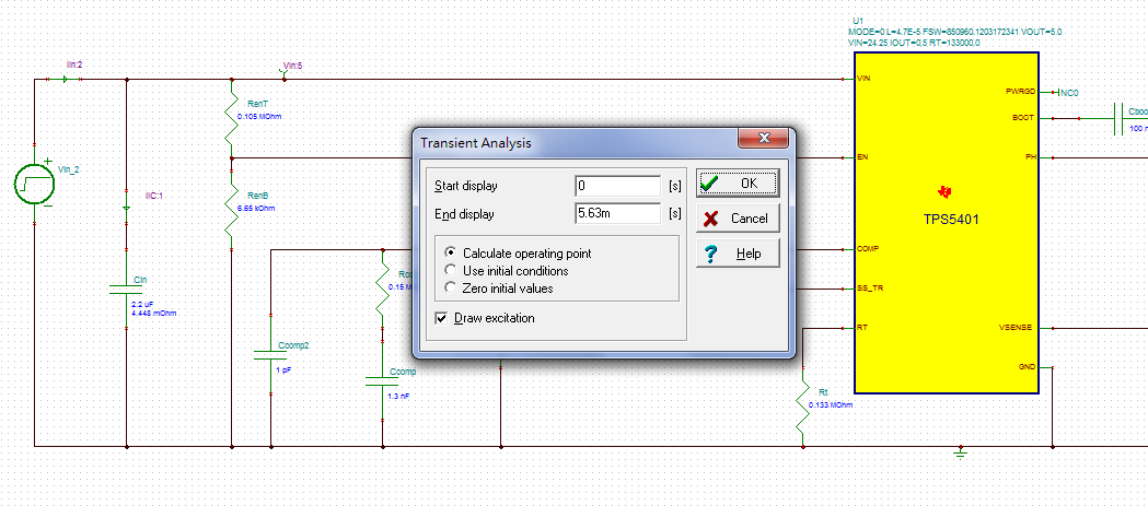

[issue] while export TPS5401 design from webench to tina-ti running under "transient analysis" with "Calculate operating point" option checked.

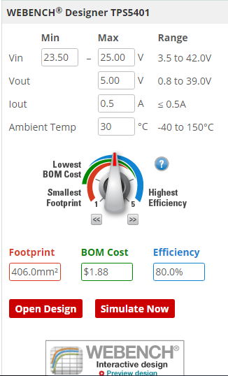

Recently I was evaluating TPS5401 based on (TI) local FAE's suggestion.Then I roughly key in some parameters into webench to generate a design and decide to export the design to tina-ti format which ready for download. Then I downloaded it.
Here is the issue, while I ran this downloaded file in tina-ti under transient-analysis mode with "calculate operating point" option checked (as title mentioned, and this is the default setting from webench convert to tina-ti),
then it went wrong with the following info:
But if I change the setting from "calculate operating point" to "Use initial conditions".
It works fine.

  • ericsson,
    The three options that appear in the window are related to how the first step of the simulation is established by the simulator. Normally, calculating the bias point will provide the matrix the best starting point for the initial step into the transient simulation. However, there are cases where the DC operating point of some structures is not well defined. In those cases, using or zeroing out the initial conditions may give the simulator the best chance to find a valid solution.
    It appears in this case that the DC bias point was not well defined, so you needed to use the initial conditions to get the simulation to converge at the first time point.
