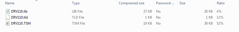

    If you downloaded the TINA-TI model from the web, you should have the following:
    Open TINA-TI and select Insert-->Macro
    Navigate to the location where you saved the model files shown above:
    Select the DRV110.TSM file and click Open. The device will be placed in your schematic.
    Alternatively, you can download the .TSC file (Reference Design) and use the ctrl-c, ctrl-v method of cut and paste as well as previously mentioned.

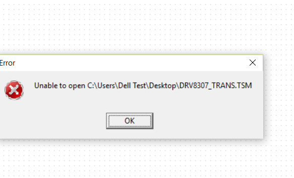

  •    I want to add DRV8307 to my circuit.I downloaded Spice Model of DRV8307.But I can not add it to circuit.
         I take this error.How I can add DRV8307 to my circuit
  • Hi user4762868,
    The DRV8307 PSPICE model and project files that you have downloaded, are in encrypted format. That means you can use it in OrCAD PSPICE version 16.2 and above only. You can not import it to any other tool due to encryption.
    To request unencrypted model, please check the following FAQ. Pay particular attention to the Getting the unencrypted model section, item 3. These devices may require an NDA before the unencrypted PSpice model could be provided.

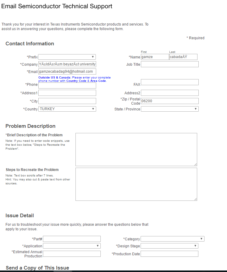

  •     Hi,
        I must fill this page and I will request an unencrypted model of DRV8307.Am I right?
    Yes, if you do not have a direct TI contact assigned to your company, you should use the form above to request the unencrypted models.
    I filled this page approximately 2 hours ago. When I can take a feedback? Could you give me an estimated date, please?
