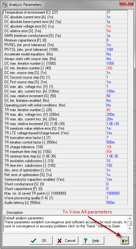

  • Sasaki-san,
    You may have to adjust the simulation parameters to get the simulation to run. Every circuit is different and the default parameters may not work well with your particular circuit. I have updated a few parameters and the simulation works correctly. Please see the attached .TSC file. The changes can be seen with the Analysis-->Set Analysis Parameters... The changes are marked in red.

  • Sasaki-san,
    I have run all three values with the attached .TSC file. Remember that you have to set FAST to 0 to see any impact of the SS resistor on the simulation. If you leave FAST=1, you will see an impact, but the values will not match the datasheet values. I ran these tests with FAST=0.
    Please note that you can change the Simulation parameters in the Analysis-->Set Analysis Parameters... pop up window in TINA-TI. You may have to select View All if the short list comes up. If the short list comes up, click on the Hand icon and select View All. Here are the settings I used for all three simulations:
    Any time you change the schematic, you may have to adjust the simulation parameters. I have not optimized these parameters for a wide range of use, but found the simplest set that would allow the simulations for the SS resistor to run correctly. Please also note that I changed the length of the simulations for each simulation run from 3m - 61.9K, 5m - 161K, and 7m for 436K.

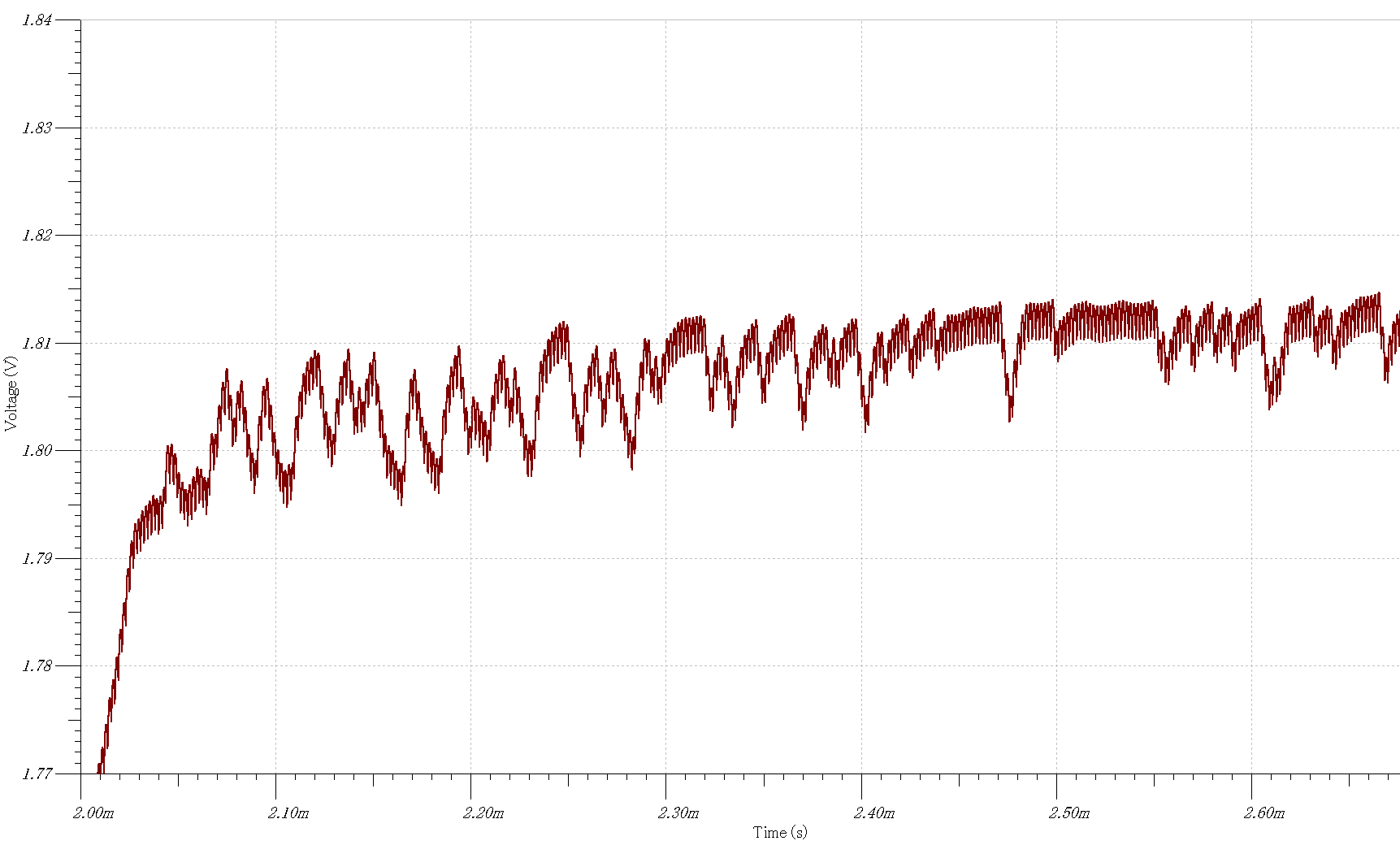

  • Britt-san,
    About the file which you attached in previous answer,
    Output voltage rises up, however output ripple and variation is large level. I think this output waveform is not normal.
    What do you think about this?
    Kohei Sasaki
  • Sasaki-san,
    Change the TR maximum time step to 20n, the TR max iteration number to 100, and the DC relative error to 3m.
    Please note that you may have to change these values to get the circuit to converge if there are changes to the circuit.
    You and your customers will need to be able to understand and make these kinds of changes to the simulation parameters. All simulators use a set of simulation parameters that will determine the trade off between accuracy and speed of the simulation.
