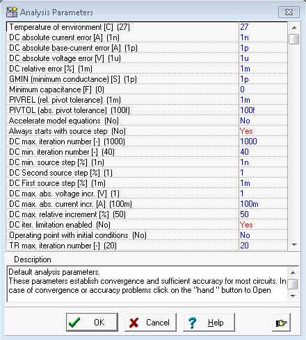

It is a 40Khz CF Band Pass filter with high gain to detect signals from an ultrasonic sensor.
It is a circuit I borrowed from here:
I am new to Tina so it may also have something to do with simulation problems however other designs I have tried seem to run as expected.
Steve
Steven,
The TINA vendor advised a slight change to the analysis parameters.
They can be found in the menu Analysis/Set analysis parameters.
The changes are shown in the diagram below.
1. Always starts with source step is changed from No to Yes.
2. DC iter. limit enabled is changed from No to Yes
Please let me know if you have any more questions.
