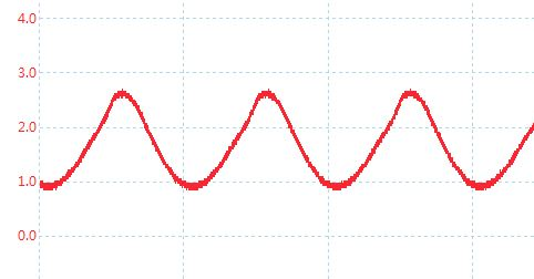

  • this afternoon, i used the ADA4841-2 to do the test,one opamp in ADA4841-2 is used for the unity gain configuration, and the other is uesd for high pass filter, the amplitude of the source is 760mv with DC voltage is 1V,
    the two exercise "1.the frequency  is 500Hz,  and 2. the frequency  is 3KHz, the results are as  follows:
    i want to ask the reason of the result ,thank You!

    The schematic
  • thank you ! please see my new problem!
  • What's the f-3dB of HPF you're trying to design?
    Also, can you attach your .TSC file or TINA file into this post so that I can take a look what's happening?

  • unitgain+MFB HPF.TSCi'm so sorry for the delay because of the vacation in recent time.
    f-3dB of HPF is 1HZ.

  • Hi In ye,
    I noticed that if you sweep the frequency response / bode plot beyond 10kHz and up to 1MHz, you'll notice there is high resonant around 65kHz. I think that's what's causing it.
    I would recommend not to use Multiple-Feedback (MFB) Architecture rather use Sallen-Key (SK) Architecture instead. I think MFB is pretty sensitive to resonant as the feedback components (Resistors and Capacitors) interact with the output impedance of an amplifier.
    Also as far as TI part, you can use OPA836.

  • hi herman:
    thanks for your reply!
    can you tell me how to find the resonant frequency! i have no idea about that !
    i hope to verify whether the schemetic is stable before designing a real board!
  • In ye,
    You can follow the following steps:
    1. Open the .TSC or TINA file
    2. Click on Analysis -> AC Analysis -> AC Transfer Characteristic
    3. Alter the end frequency to "10M".
    4. Click "OK".
    5. Observe the graph that comes out of that.
