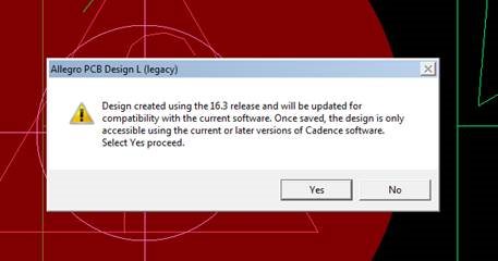

    We need to follow the below steps to open the Allegro board file :
    1.      Right click on the batch file (2017-09-01_12-21-21) and select Open.
    2.       Click on Run in the pop up window.
    3.      Select allegro PCB tool.
    4.      Choose Yes when the below shown pop-up windows appear. ( Please note, this pop up window appear multiple times and we need to choose Yes everytime)
    5.       Once the script runs successfully, we can see the board file in the same folder. ( This process will take 5 to 10 min )

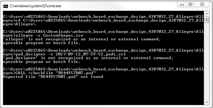

    Thank you for the detailed instructions. On step 1, when I right click and open - I receive the below error and it does not continue.
    I had my customer try as well as we saw the same error.
    Do you have an idea of why this error is popping up?

  • Hi Reed Kaczmarek,
    Can you please let us know which version are you using?
    We tested in Allegro 16.5 and 16.6 versions and the script run was successful and we were able to see the board file.
    Installing the Hotfix could solve the issue.

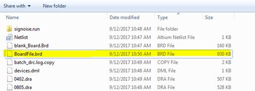

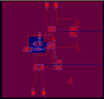

       We ran the script and the board file is in the attached folder. Please let us know if this works.
    webench_board_exchange_design_1235539_50_Allegro.zip
    We have used Cadence Allegro 16.5 and 16.6 versions with Hotfix installed and we didn't see any issue.
    Please check with full version with hotfix installed if possible.
    Janardhan S
  • Thank you for sending over the correct .brd file - this is going to be helpful.
