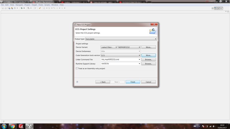

  • Hi Paul,
    Thanks again for the reply. I'm new to this and as such I really don't know what I'm doing, so I've attached some screenshots of the menus that have popped while trying to go through your instructions.
    at this point I pressed finish and went for the target
    I couldn't find the MSP430x2xx Family, am I doing this right?
    Also, attempted to build with those definitions but an error occured due to a failed attempt to open msp430f2232.h
  • Hi Jmfras,
    It appears that I have a different version of CCS than you do. It does look what you are doing is correct. I won't be able to exactly assist with some of the CCS errors, so I would post a question into that forum to get help on why the msp430f2232.h is missing from your system. Likely it is just not having the system set up to point to that file.
