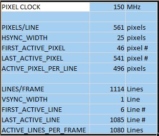

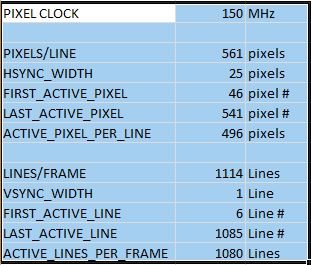

  • So to recap, the 2 ports per DLPC, only one will have the overlap region, right?
    And do you have the FPGA code I could get modified and synthesized by 3rd party to determine which cheaper FPGA I could use for my specific use case?
    And getting back to the OP, if I want to tell the DLPC that I want it to run at 240Hz @ 1080p (with two controllers) with 25% black per frame, how can I get such a firmware generated for the controller? Is there a dedicated program for that?
    Thank you.
  • >> So to recap, the 2 ports per DLPC, only one will have the overlap region, right?
    Yes one port contains overlap data
    The FPGA code is currently provided in binary format due to IP; i think it would be easier if we provide the timing and resolution information on how it should be split then it should work for you; but it is going to take while because we are yet to plan on this part.
    To make sure i understood correctly, on your question specific about source, the DLPC has built in source detection logic, so after sending command to switch to external projection mode, it will automatically configure and display the source.
    Now, with 25% black per frame, you meant to say @ 240Hz 4.16ms time window, you want to display content for 75% of the time i.e., 3.125ms?
    Sanjeev
  • >>i think it would be easier if we provide the timing and resolution information on how it should be split then it should work for you; but it is going to take while because we are yet to plan on this part.
    I guess. I assumed there may be something more going on other than timing and splitting but if that's all I guess that is all I need to pass to a FPGA programmer.
    At this point I am again not 100% sure we really need an FPGA for this, video splitting sounds something a ready IC might be able to do. At the very least if 4 1080p video frontend chips are wired to the same HDMI or DisplayPort port but set to crop the incoming signal differently they will probably remain in sync if synced on startup and still be a more economical solution over the listed FPGA. But other than this there's probably a dedicated IC that can do the same alone.
    But in any case please provide the data when you can. Is there an estimated date when it will be available?

  • Hi Mike,
    Sorry for delayed response. Here is the video timing that needs to be sent to DLPC6421 on each port.
    From 1920x1080
    To
    992x1080 per DLPC6421 controller
    Then dual pixel mode
    496x1080 per port (there are two ports per controller)
    Now, from 992 pixels to 496 pixels, on PORT_0 you need to send even pixels 0,2,4,6,8,.... and PORT1 you need to send odd pixels 1,3,5,7,...
    Sanjeev
