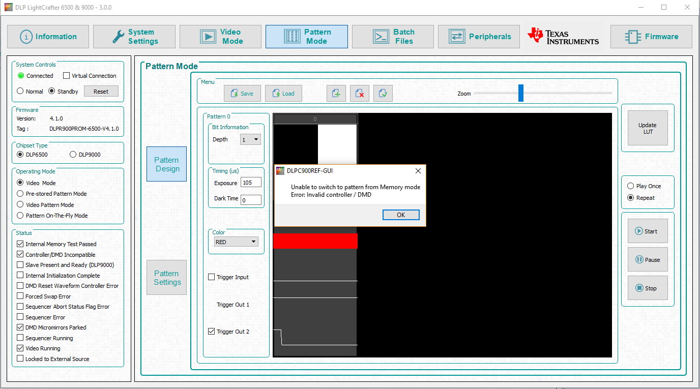

I started working with a DLP LightCrafter 6500 module in both video and pattern mode but since yesterday it does not work anymore.
Board: USB connection works, the heartbeat LED is blinking but it remains in standby mode and I get the error message "Invalid Controller/DMD" when I try to switch modes and the status "Controller/DMD incompatible" is ticked. (Image 1)

Image 1

  • Hello Klaus,
    First,  welcome to the DLP section of the TI-E2E forums.  We are glad you are here.
    Did you happen to handle the controller [edited] **DMD** board during operation or while powered up?  It is possible to damage the DMD if the wrong point on the DMD is touched when powered up.
    The excessive heat is often a symptom of this,  Do you have only the one EVM?  Also when did you purchase the EVM?
    Replacing the DMD typically solves this issue.
