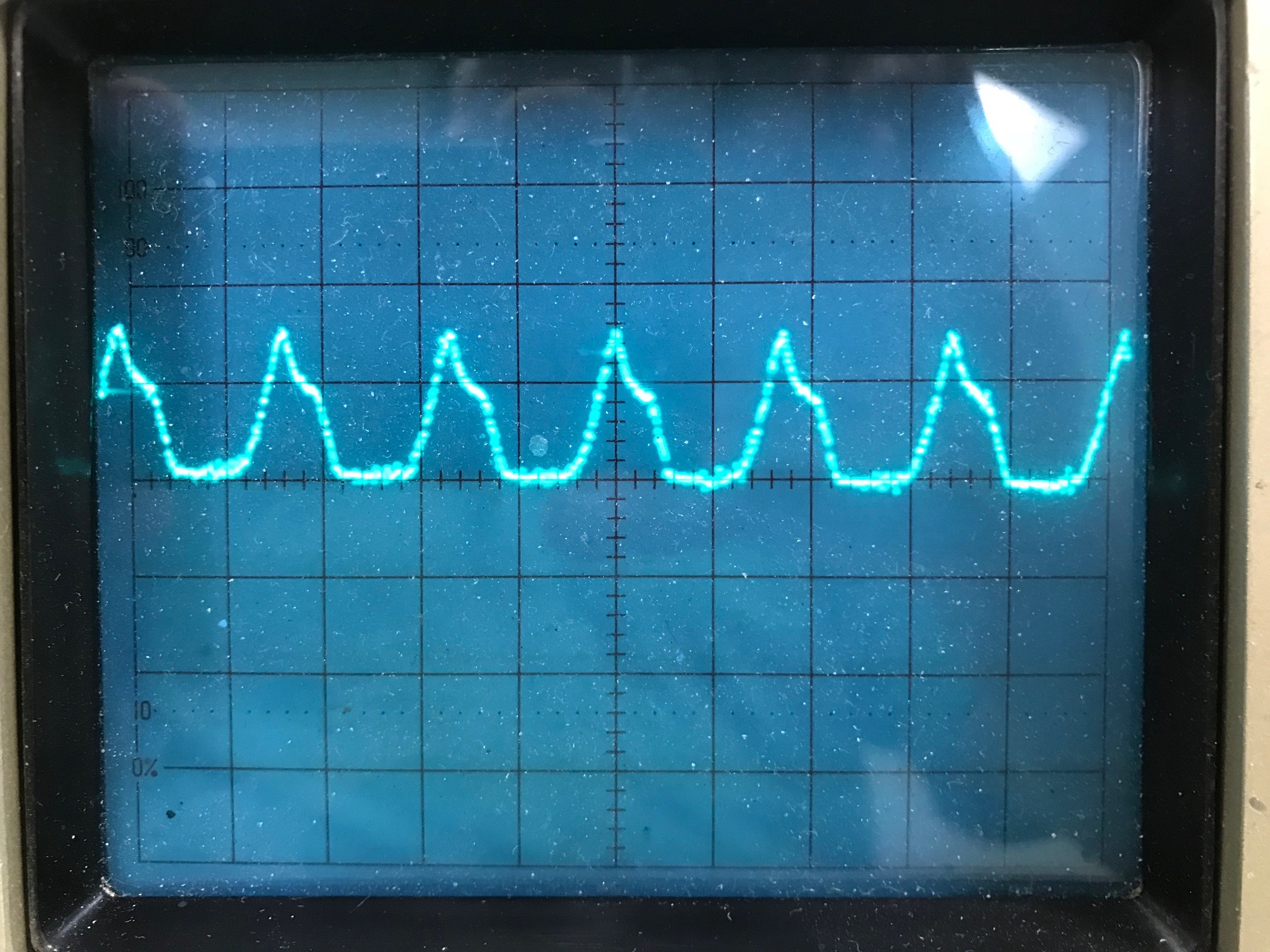

  • Kyle,
    The link below is an earlier post and addresses the 3010EVM VSYNC.  VSYNC was available on TP2 after a firmware update.
    For the 2010EVM I am hoping there is a similar solution.  The signal on R64 appears to have the correct timing (~1.8V P-P, ~17ms, assuming it should be similar to the 3010EVM) but the the signal is not a clean square wave seen on the 3010EVM.  This signal may work but I will have to try before I know for certain.  I soldered a wire to R64 to get at it on the side away from the chip.  Maybe tapping in between R64 and the chip is a better location.    Do you have any other thoughts?

  • Hi Kyle,
    TP2 was the first thing I tried before writing to the forum. I do not see a signal on TP2. Firmware for the projector was downloaded from the TI site yesterday and uploaded along with new splash images. I assume the while the signal may be available on TP2 the firmware does not support it. This was the case with the 3010EVM. Is it possible to get firmware that supports a VSYNC output for the 2010EVM?

  • Kyle,
    After reflashing the EVM with recently downloaded firmware there is now a clean VSYNC signal on TP2. However, after using the flash update function in the GUI to add new splash images to the recently downloaded firmware VSYNC disappears. If the the unmodified firmware is uploaded again VSYNC is back. There appears to be an issue that wipes out VSYNC when I update the splash images. Please advise.
