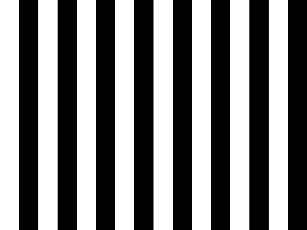

I have been trying to modify the APPS FPGA sample code to change the patterns displayed on DMD with the DLP 4100 Kit.
With the following code in pgen_a, I expected 16 vertical strips that the ON and OFF alternatively. However, the DMD display showed only 8 vertical strips. Any specific reason for this?
The resolution of the DMD used is 1024 by 768 so that only data buses A and B are utilized.

    I loaded the .bit file and the DMD really showed 16 columns ON and 16 columns OFF, with a column width of 32.
    However, this doesn't solve my problem since I want to use the variable cnts_active_cnt_q1 (or q2, q3) to control the columns.

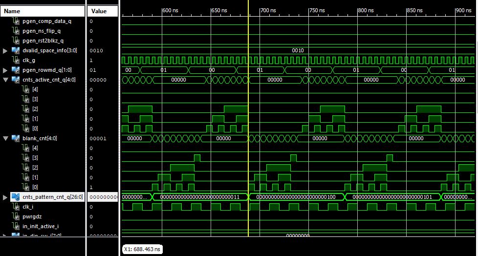

  • Hi, ykc,
    Thank you so much for the files.
    You mentioned that active_cnt is run twice per row. But the simulation shows only once.
    For each row, the blank counter runs first, and then the active counter, as shown in the figure below.
    This is actually consistent with my observation. With the condition of cnts_active_cnt_q (0) = '0', the DMD shows vertical strips with 128 pixels ON and 128 pixels OFF alternatively, since 1024 / 8 = 128.
    IF cnts_active_cnt_q(0) = '0' THEN

    I still have the problem in generating 64 pixels ON and 64 pixels OFF, as shown in the figure below.
    Could you please give some comments on how to generate such a pattern?
    Qiang
