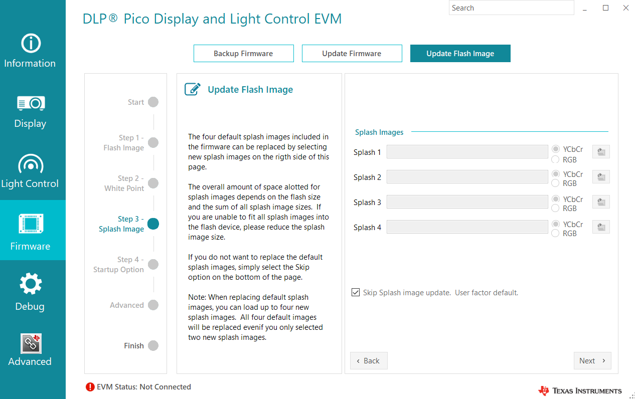

Could you tell me how to change data of Splash Screen in DLP3010EVM-LC ?
If you have any manual, Please let me know.

Hello Hiroyasu,
The GUI can be downloaded at http://www.ti.com/tool/dlpdlc-gui. This GUI can update the splash images in the firmware tab of the GUI by following the steps from Start to Finish on the left side of the screen.
Please let me know if that makes sense or if you have any additional questions.
