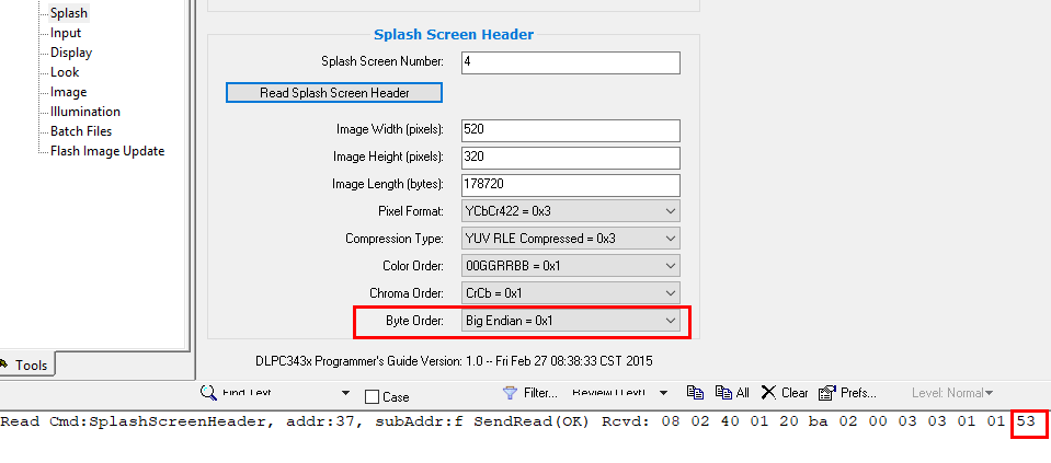

I'm using the DLPDLCR3010EVM-G2 tool to project some custom images. When I use the command "Read Splash Screen Header (0Fh)" in advance GUI
The last byte I got is 0x53, but in Programmer's Guide. it shows:
My question is how to understand the 0x53 as byte order? Why in advance GUI it gives the "Big Endian" result?

    Yes, i checked at my end. I can also see the 0x53 as last byte.
    It is not expected, i will investigate more at my end and will share the findings soon.
    Do you have any specific application related to byte order ?
    I can confirm that the correct byte order is "0h".

    I'm going to customize our own splash images for display some patterns. So I'm querying the default splash header to see the format that can be accept by the device.
    When I check the byte order value it makes me confuse. I don't know how to parse 0x53 to big or little endian.

    Note : We found other issue related to splash header read command (13th byte is not required), we will resolve it in our future releases.
