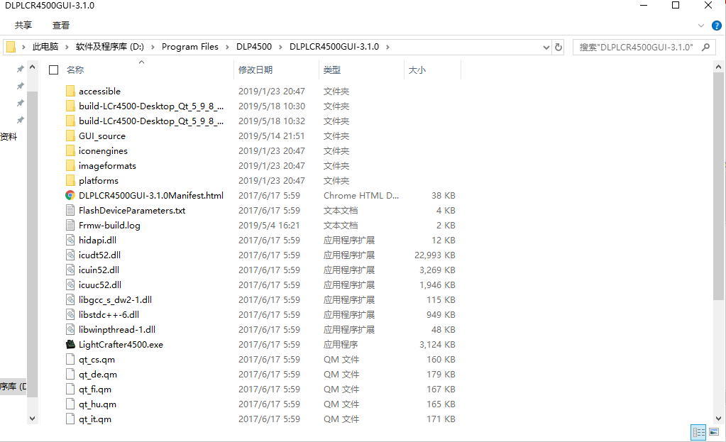

    I used Win10 OS, and I am using the GUI download from the official website. version is 3.1.0
    Because I used qmake to make a vs proj, so exist some other files and folders, but I did not change the original GUI .exe and any .dll
    I copy a new proj to develop.
