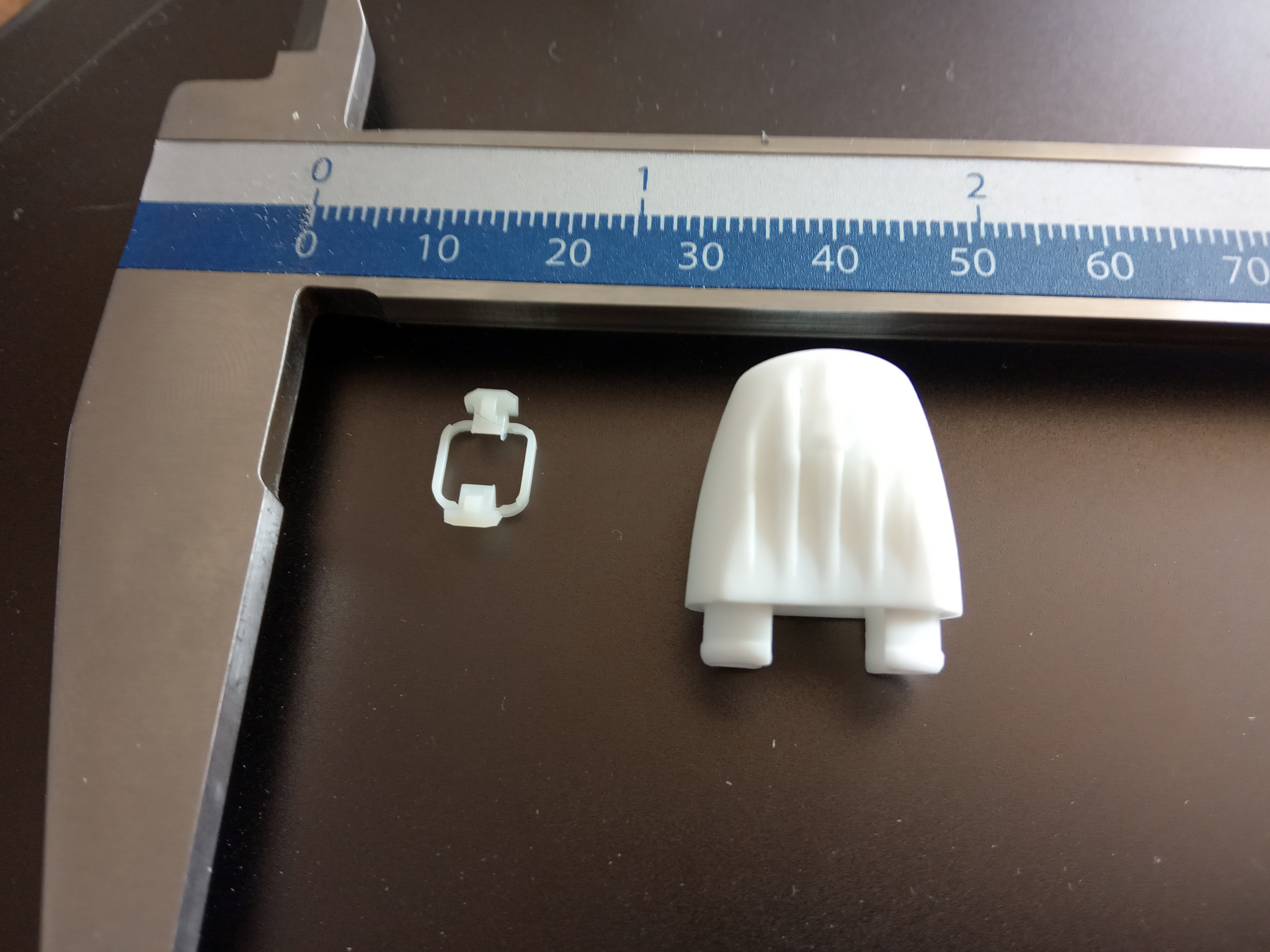

  • This is an example of the smallest objects that would be scanned:
