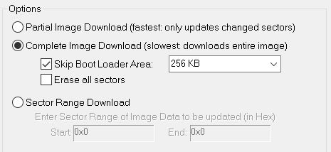

    Also when you downloaded the other file, did you check the "Skip Boot Loader Area" in the GUI?
    My concern is that when you downloaded the other file, you may have deleted the bootloader portion in the memory.

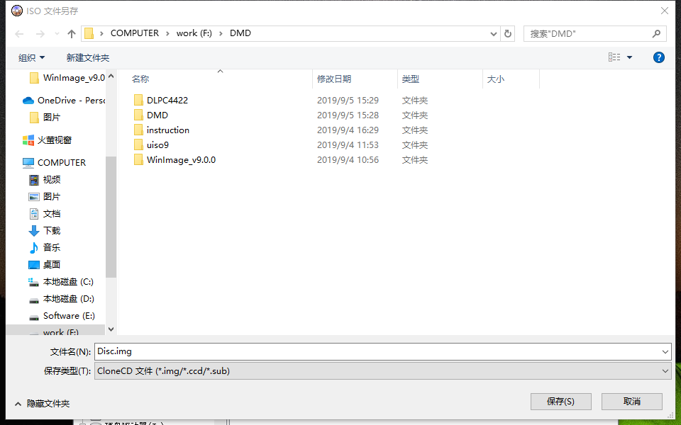

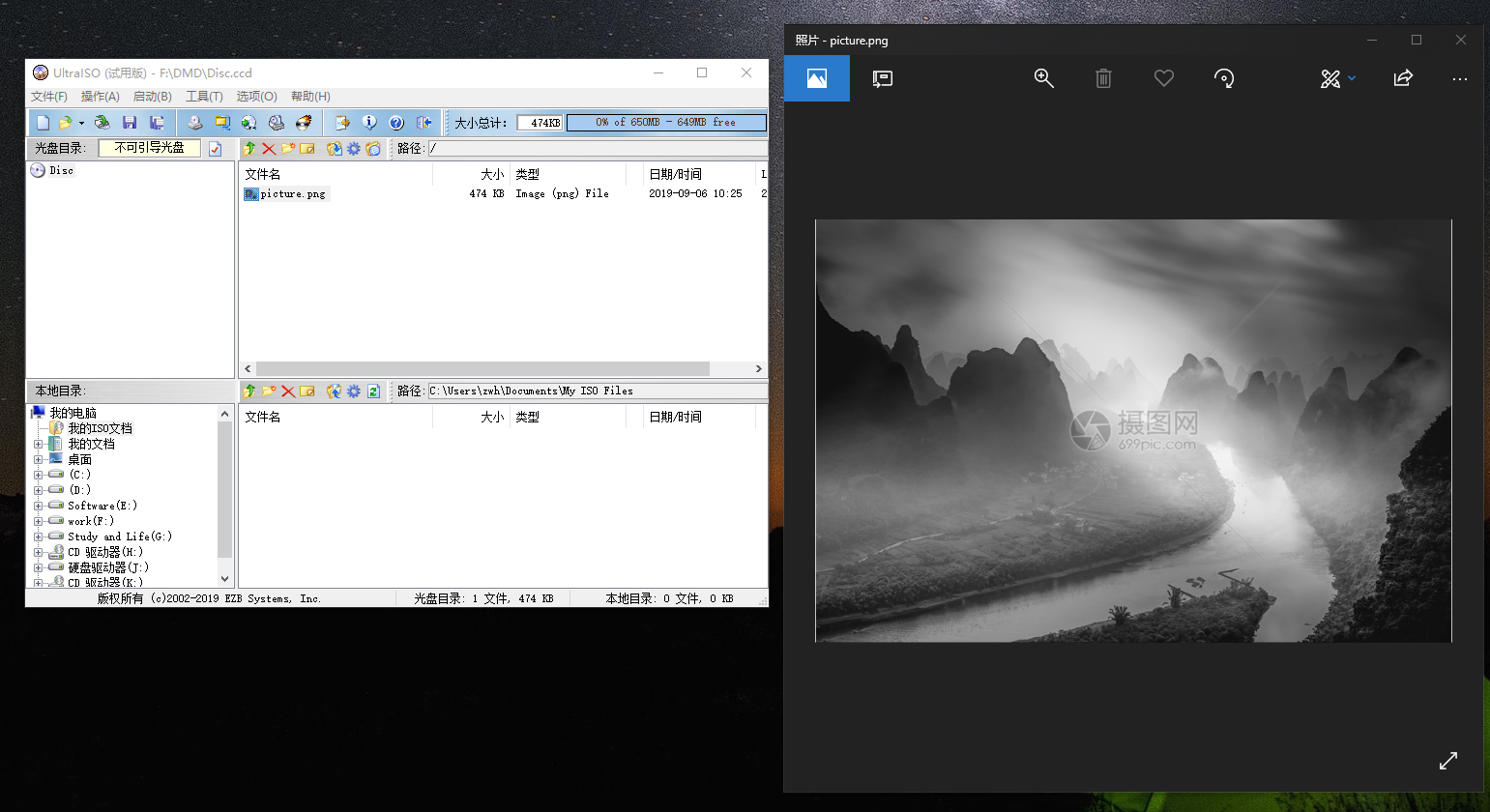

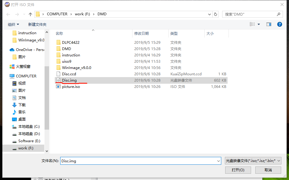

    I downloaded some software to convert the format from .png to .img.
    1.save a file as .img format.
    2.Resulting file
    3.Open the file by a software
    I am confused that what kind of files can be recognized by DLPC4422.Files in .jpg .png .iso or in any other fomat?
    Thank you.
  • There is no mechanism to update the splash image (DLP® logo) using the DLPC4422 GUI.  This can only be done using tools that are released customers with NDA and development agreements in place.
    The .img file used by the flash loader is a binary flash image file.  This .img file contains contains DLPC4422 controller software, configuration data, boot loader, etc..  It is not a picture file.
    By programming a picture file using flash loader, the entire flash contents has been replaced with a picture; this includes the boot loader since it was not skipped.  At this point, there is no software in the flash.
