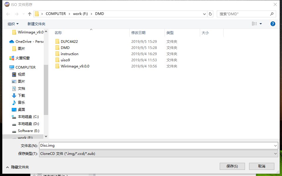

I am afraid that I have deleted the bootloader portion in the memory because I did not chose to skip boot loader area. How can I remedy this?
My second question is about the flesh files.
I downloaded some software to convert the format from .png to .img.
1. save a file as .img format.
2. Resulting file
3. Open the file with a software
I downloaded this file to the DLPC4422 but it showed nothing.Maybe it's the problem of boot loader portion, but I am afraid that the file format is also wrong.
I am confused that what kind of files can be recognized by DLPC4422.Files in .jpg .png .iso or in any other fomat?
Thank you.
  • Per my answer in your original post (DLPC4422: unable to communicate with PC), there is no mechanism to update the splash image (DLP® logo) using the DLPC4422 GUI.  The .img file used by the flash loader is a flash image file containing the DLPC4422 controller software, configuration data, boot loader, etc..  It is not a picture file.
    By programming a picture file using flash loader, the entire flash contents has been replaced with a picture; this includes the boot loader since it was not skipped.  At this point, there is no software in the flash.
    Unfortunately, if you cannot communicate with the board both with and without J31 HOLD_BL in place; the board is now unusable.
