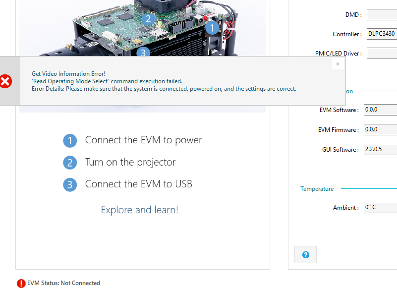

  • Hi Mayank,
    Thanks for the answer.
    I downloaded the DLPPicoDisplayAndLightControl.2.2.0.5.Setup file, installed it and ran it connected to the EVM according to instructions.
    There are still problems. Now, the controller name (DLPC3379) was fetched, but not the DMD or PMIC/LED Driver (image 1):
    Furthermore, the problems with the Test patterns and Splash image remain (image 2)
    Also, it says that EVM Status is "Not connected" ???
    Any other suggestions?
    BR /Björn
  • Hi Bjorn,
    Make sure you are using the latest firmware available here : http://www.ti.com/tool/DLP4710EVM-LC
    Once there is no power to EVM you will see "EVM Status: Not connected".
    Toggle switch SW28, now also you will see "EVM Status: Not connected" -> click on "EVM Status: Not connected" or restart the GUI -> now you will see "EVM Status: Connected, powered Off".
    Now you update the correct firmware, get it from above link (I am suspecting you might have updated the display EVM firmware in this EVM, as you were using Display light crafter GUI, if this is not the case then no need to update firmware..... for safe side I would suggest you may program the latest firmware)
    Once successful program firmware  -> press the SW21 switch -> displays splash screen -> click on  "EVM Status: Connected, powered Off" or restart the GUI -> you will see " EVM Status: Ready: Splash Screen
    Navneet

  • Sorry for not getting back to you, but now it works, after firmware upgrade. Thanks for your help
    BR
    Björn E
