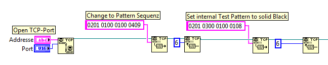

    In the course of a project I also needed to control the Lightcrafter via LabView.
    Here is my solution:
    For normal commands I send the information easily via strings:
    For sending pictures to the Lightcrafter you have to split the bmp-Files into smaler packetes with a maximum size of 65535 bytes!
    For this I used this SubVI:
    To send the packets to the LightCrafter you have to create the commandline automatically like this:
    The code works pretty well!

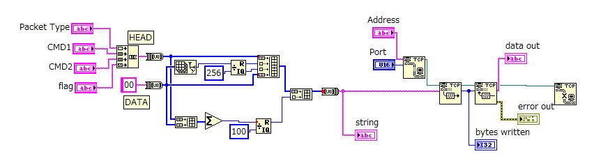

  • Hi all,
    I try to operate the Lightcrafter by using Labview.
    However,TCP read command is not output.
    What's wrong with our program?
    [error code]
    TCP read: code56
    [input parameter]
    Packet type: 02
    CMD1: 01
    CMD2: 01
    Flag: 00
    Data: 00(static image)
    [output parametors]
    String: 0201 0101 0002 0030 3065
    Bytes written: 10
    Data out: none
    Error out: code56 (TCP read)
    k.s
  • Hello K.S.,
    The error code listed [56] is a time out error on the TCP read.  The first thing to try is to put a delay between the TCP write and TCP read.  Try adjusting this value in 2x increments - i.e. 10, 20, 40, 80, . . .).
    Let us know the result.
    Fizix
  • Hello, Fizix,
    Thank you for your response.
    Above problem is solved to modify the CMD.
    (CMD1: 01, CMD2: 01 →CMD: 0101)
