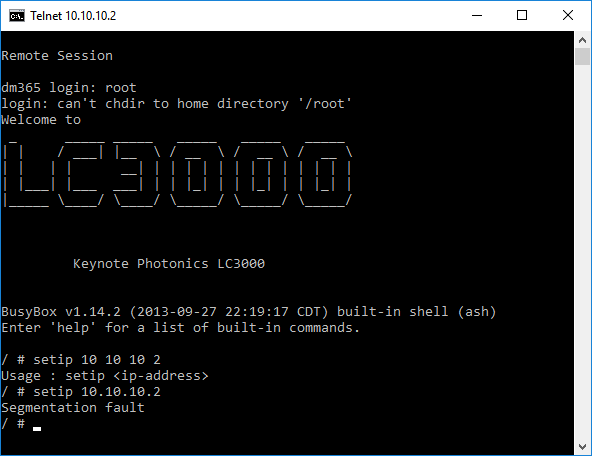

  • Hi Pedro,
    Thanks for your suggestion. I have copied the whole "Changes" folder from older build to current one called ti-dvsdk_dm365-
    evm_4_02_00_06. This Changes folder includes among other things, the setip executable in bin folder.
    Then I have rebuild the DVSDK according to manual:
    In folder of DVSDK (home/"username"/dvsdk_dm365-evm_4_02_00_06 I ran:
    make clean
    make all
    make components
    After that I connect vial telnet to DM365 to run setip, but when I enter "setip 10.10.10.2" , I get "Segmentation Error".
    I thought it may be that the format should be different, so i tried others like "setip 10 10 10 2" etc, but I think but it looks like the format of address should use dots.
    Do you know what this segmentation error means?
    And also, if after the issue with setip is solved, how can I build my custom *.dat image with the changes such as new default address to load it from SD card instead of the one provided by TI (lcr_dm365_v5_sd.dat)?
    Karl
