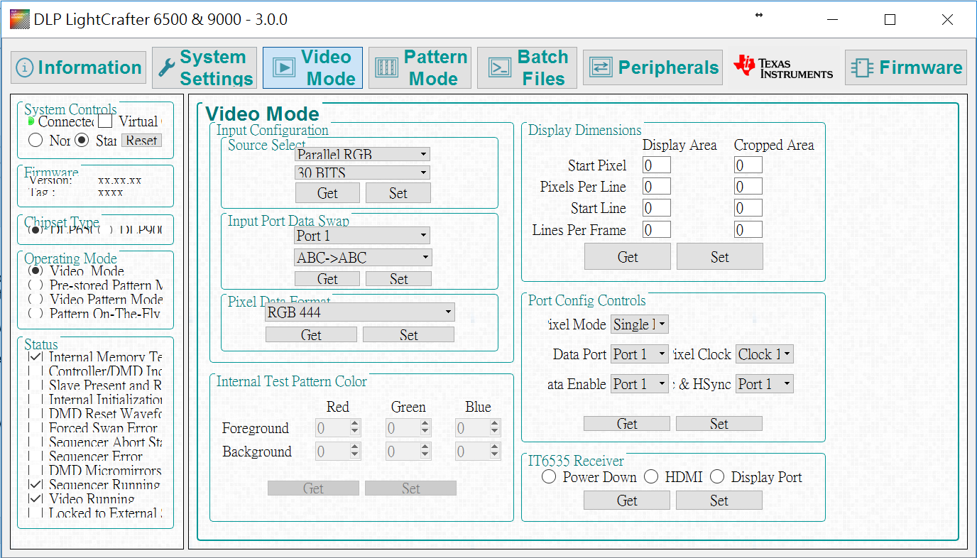

I have a DLPLCR6500EVM. It have functioned normally until I connected it to my computer with HDMI cable in video mode and set IT6535 Receiver to HDMI. In the beginning, it worked normally(this means DMD shows screen of computer). Suddenly, it disappeared. Then there is no reaction and no screen image.

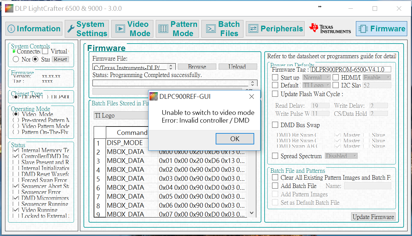

So I reboot the DLP, and it didn't show anything(TI logo default originally). I tried to use GUI to check the problem, when opening the GUI(version3.0.0), it shows
"Unable to switch to video mode"
"Error: Invalid controller/DMD"
and it switched mode automatically between Video and Pre-stored Pattern mode (non-stop switch)

  1. reset the board, it shows "unable to reset the board, Error: i"
  2. switch to Pattern On-the-Fly mode, it shows "unable to switch to pattern from Memory mode, Error: i"
  3. switch to Video pattern mode, it switches back to Pre-stored Pattern mode automatically.
  4. check leds. D5 off,  D6 Heartbeat LED blinking, D8 Power LED on, D9 PWRGOOD LED on

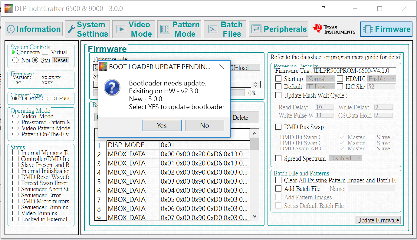

so I upload the firmware V4.1.0
When upload successfully, the DLP6500 seems auto-reboot, then has the same problem

  10. choose firmware, browse firmware C:/Texas Instruments-DLP/DLPR900PROM-4.1.0/DLPR900PROM-6500-v4.1.0/DLPR900PROM-6500-V4.1.0.img
  11. press upload. Then it shows "Bootloader needs update. Existing on HW - v2.3.0.  New- 3.0.0. select yes to update booltloader", then select "yes"
  12. After complete upload, it reboot, but still have same problem I mentioned above
