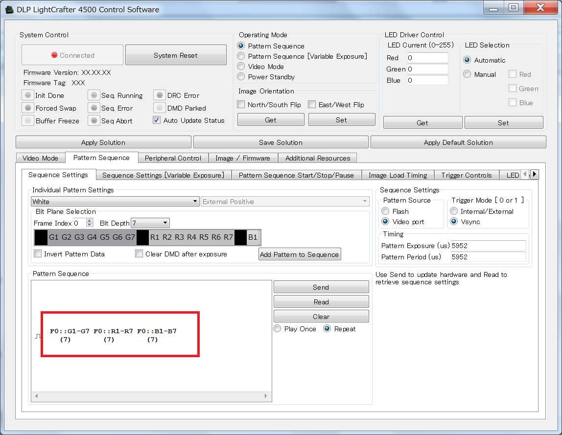

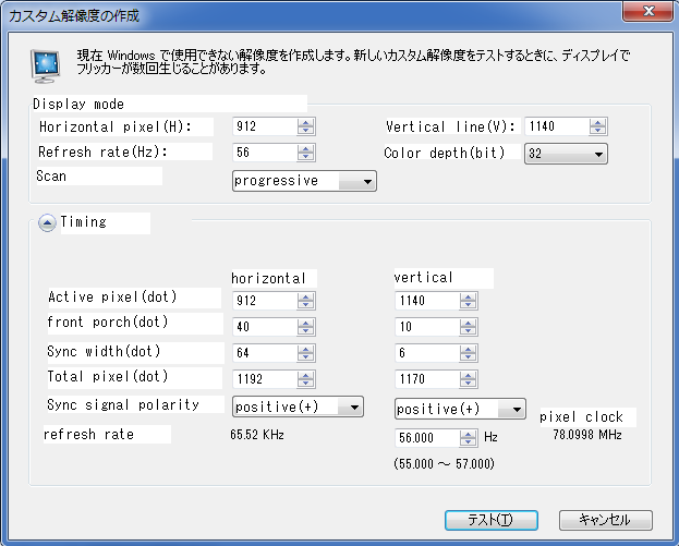

On the LCr 4500, images were projected from the HDMI input with the settings below. For the video generator setting, the image size was 912 x 1140 and the frame rate was 74 Hz. After that, the setting of the video generator was changed, and only the frame rate was changed to 56 Hz However, like the attached movie, fluctuations like jitter occurred in the image. What is the cause?

  • Hi Masayuki-san,
    It appears that your image has different color content for each of the bit planes. If you repeat the same bit planes 3 times do you still see the same flickering effect?
    Paul

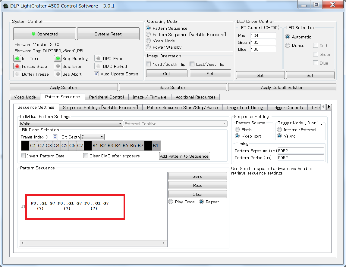

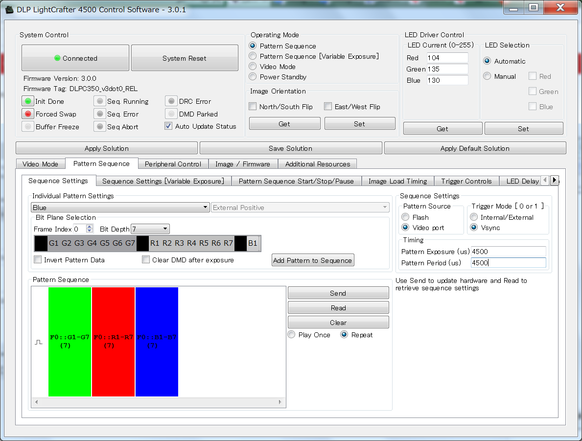

  • Hi Paul,
    Thank you for answering. Yes. I tried two ways. One is when different bit planes (G - B - R) are displayed with the same color. The other is when display the same bit plane (G - G - G) with the same color. As a result, the flickering effect occurred in both cases.
    Masa

  • Hi Paul,
    Thank you for answering. Image data is generated by PC graphic board.
    The PC settings are shown below. It seems that it is outputting with a size of 912 x 1140.
    Please check with your Lightcrafter 4500.
    Masa
  • Hi Masa,
    I have tested on my Lightcrafter with your settings and am not seeing the behavior that you are reporting. The next thing you should do is check that your input video settings match the requirements given in the DLPC350 datasheet, section 6.11. www.ti.com/.../dlpc350.pdf

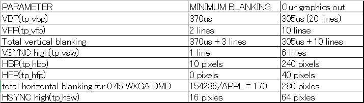

  • Hi paul,
    Below is a comparison of Table 3 of Section 6.11 with our graphics board settings.
    Each parameter seems to have no problem.
    (VBP is less than 370 μs, but it seems to be the same in the example of Table 4)
    Could you teach me the image parameters you tested?
    Masa
  • Hi Masa-san,
    I should have been clearer - I tested my Lightcrafter using your pattern sequence settings, not the video parameters you showed. From your table, it looks like your parameters are good.
    What I would recommend next is to try playing with your frame rate a little to see if there is any frame rate where the issue goes away. My computer offers fairly limited control of frame rate, so you'll have to do that testing.
    -Paul
