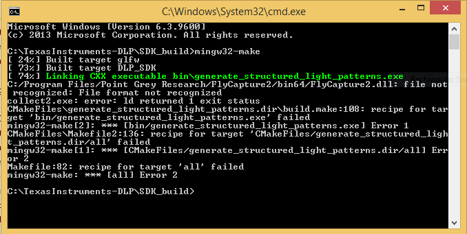

I am struggling to build the SDK ; I followed all the steps, and had many problems which I managed to solve with the answers to the other threads about building the SDK.
In particular, I had the same problem with the FlyCapture dll files as in this thread, where errors occur in the CMake configure step, to build the DLP ALC SDK.
I downloaded the Point Grey FlyCapture2 full SDK, as advised in the thread answer, and managed to go to the next step : running the make command line.
That's where I get stuck : At 74%, the build fails as the format of one of the dll files from Point Grey is apparently 'not recognized' (see screenshot, the first 74% do not appear as they were previously successfully built).
I have rigorously followed all the steps from the SDK guide before this one. I run Windows 8.1 with 64 bit OS, x64 processor.
Can you help me out with this ? Thanks for the help !
Tristan
  • Hi Tristan,
    Thanks for your question and welcome to the DLP Forums!
    My guess is that perhaps you downloaded the 64b version of the FlyCapture SDK? We did everything in 32b. Can you download the 32b and try again to see if that fixes your issue?
    -Paul
  • You nailed it, thanks ! It was built successfully with the 32b version

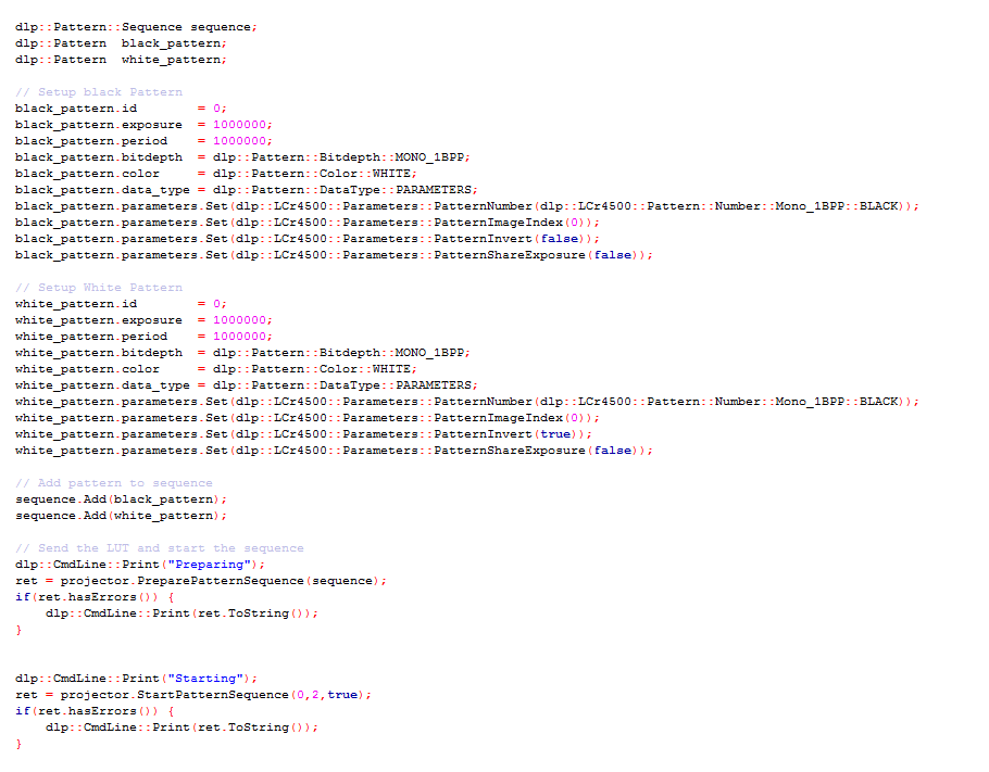

  • Paul,
    Thanks for your advice, I managed to get started with all this and am trying to understand how to use the SDK. I am trying to use basic functions to interface with the SDK, and tried to use the ProjectSolidWhitePattern and ProjectSolidBlackPattern functions, with the following code (editing the TIDA main.cpp file). There is no error, the connection works fine and the debug messages look good, but I cant see anything on the DMD ... Is there anything wrong ?
    Tristan
  • Hi Tristan,
    I don't see anything glaringly wrong, but it's difficult to say when it is being applied outside of the TI design. I recommend that you take a close look at how this function is used in the TI Design and make sure that you are setting the right configurations before calling the function.
    Sorry I can't be of more help.
    Paul

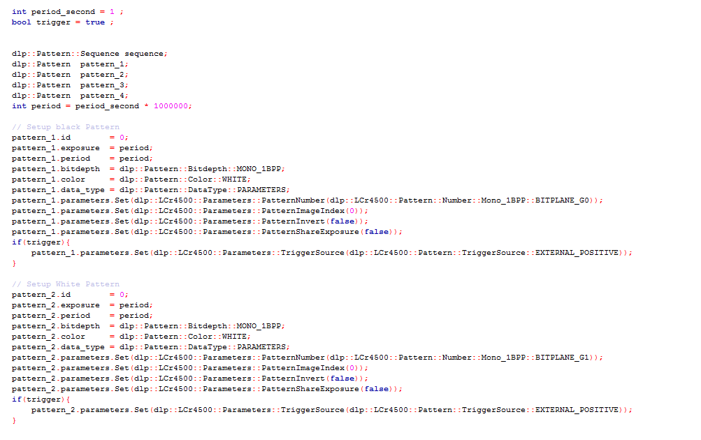

  • Oh I was waiting for your answer, but just saw it now ! Thanks for your answer, still did not manage to make it work... But I managed to show black/white patterns by using this code instead (inspired from the definitions of ProjectSolidBlackPattern) :
    I am interested in displaying a sequence of images from flash, while controlling the display moments with the trig in, and understood that this works (by choosing the correct bitplane, and activating Ext_positive triggering) :
    Now, one issue arises when using External trigger with the sdk : at the end of the period time, the DMD displays a black pattern while waiting for the next trigger signal. This is annoying : I want the DMD to display an image when I trigger, and change when the next trigger arrives, without displaying something else (=black) in the meantime. This is possible in the GUI : unchecking the "Clear DMD after exposure" for all patterns does exactly what I want.

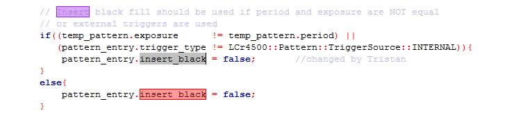

    But I understood that the SDK would not work for that : the CreateSendStartSequenceLut function in lcr4500.cpp assigns insert_black bool to true when the trigger source is not Internal. So I changed this to false whenever the function (only this one) wanted to insert a black pattern. I recompiled the SDK, used the new libs to run my main.cpp program. See an example of my changes to lcr4500.cpp :
    Problem, the sequence validation now fails : "Black Vector Missing when exposure less than frame period". This corresponds to an error on the BIT3 of the DLPC350_CheckPatLutValidate result. I have spent a lot of time in the source code of the GUI to understand if there is a trick when trig is ext_pos and insert_black is false simultaneously, but I cant find anything. I dont understand why this works in the GUI and not with my slightly modified SDK.

  • Hi Tristan,
    I missed that you set your exposure to 1s in your code - thanks for pointing that out. I don't believe that there is anything special going on in the GUI. Looking at the SDK, I saw the following. Please bear with me because I am not sure which code will exactly apply to your situation, so I'm just brainstorming:
    // If using external trigger and NOT the first pattern, set the
                // previous pattern to clear the DMD after its exposure
                if( (sequence_LUT.size() != 0) &&
                   ((pattern_entry.trigger_type == LCr4500::Pattern::TriggerSource::EXTERNAL_NEGATIVE) ||
                    (pattern_entry.trigger_type == LCr4500::Pattern::TriggerSource::EXTERNAL_POSITIVE))){
                    sequence_LUT.at(sequence_LUT.size()-1).insert_black = true;
    Did you change that last insert_black to false?
    I'm digging into your question and seeing what else I can learn. I'll post back if I've got some for information for you. Would you be able to attach all of your code so that I can take a look at it?
    Paul
  • Hi Tristan,
    I did a little more digging and the BIT 3 warning that you are receiving is just a warning. If you notice in the GUI, you'll see that the indicator goes yellow meaning that the flag is thrown but that the sequence can proceed. You may need to modify the SDK code to make sure that the flag is ignored.
    Effectively, the flag is used so that users are aware that if they do not put in the black fill, the pattern they set may not be precisely exposed.
    -Paul
  • Indeed, there is a warning in the GUI, but it still works. How can I force the SDK to ignore this warning ? What should I modify ?
    I have changed all the insert_black in the lcr4500.cpp as you can see in the attached file.

  • You'll need to modify how your code handles the value returned by "DLPC350_StartPatLutValidate" so that the flagged error doesn't stop anything.
    -Paul
