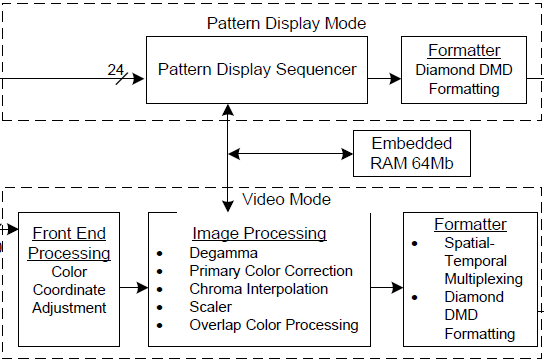

    Based on the picture in the manual (If it is not allowed to upload the picture in the manual, please tell me.)
    the video mode implements more image processing functions such as gamma correction and chroma interpolation(Actually I do not know these) than the pattern display mode.
    I think those image processing techniques are mandatory to get natural images and for my project. So I tried to find if there are the functions for video mode in the given source code(LightCrafter4500_GUI_Source_Code_v3.0.1), but I could not.

  • The Lightcrafter 4500 with auto lock onto any video source coming in from HDMI and play it in 24b mode. You can test this by hooking it up to a computer or laptop.
    There is no sample code related to video mode as you've described it for the Lightcrafter 4500. We designed the LightCrafter 4500 for industrial applications which make use of patterns and the focus was not on video project like you're interested in. With this device, we do not offer adjustment of any of the video parameters (gamma, chroma, etc.).
    You may want to look at the DLPDLCR3010EVM or the DLPDLCR4710EVM-G2, which are more strictly video focused.
    -Paul

    But since I do not have enough time and money, I will try with pattern display mode and functions related to the image processing in LabVIEW.
    I want to ask you that is there any additional functions used in video mode, which is not shown in the figure above?
    If there is any guideline or explanation about the detail of video mode, please let me know.
  • You can find all the details about what can be controlled over USB and I2C in the DLPC350 programmer's guide. This includes video settings and pattern sequence modes.
