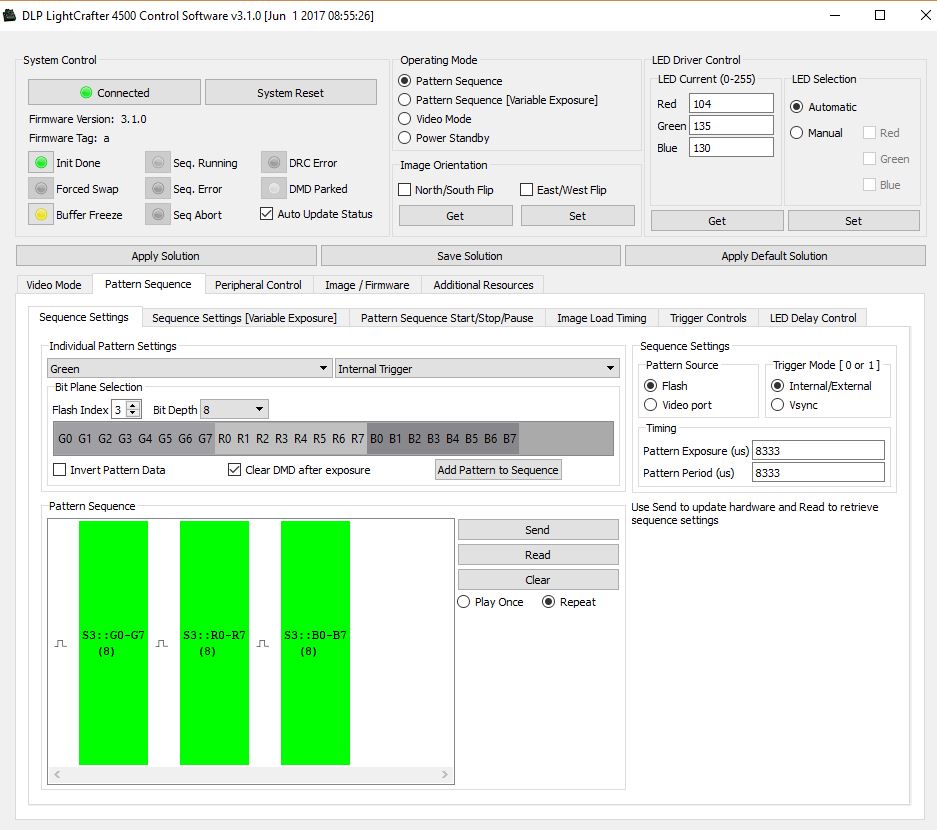

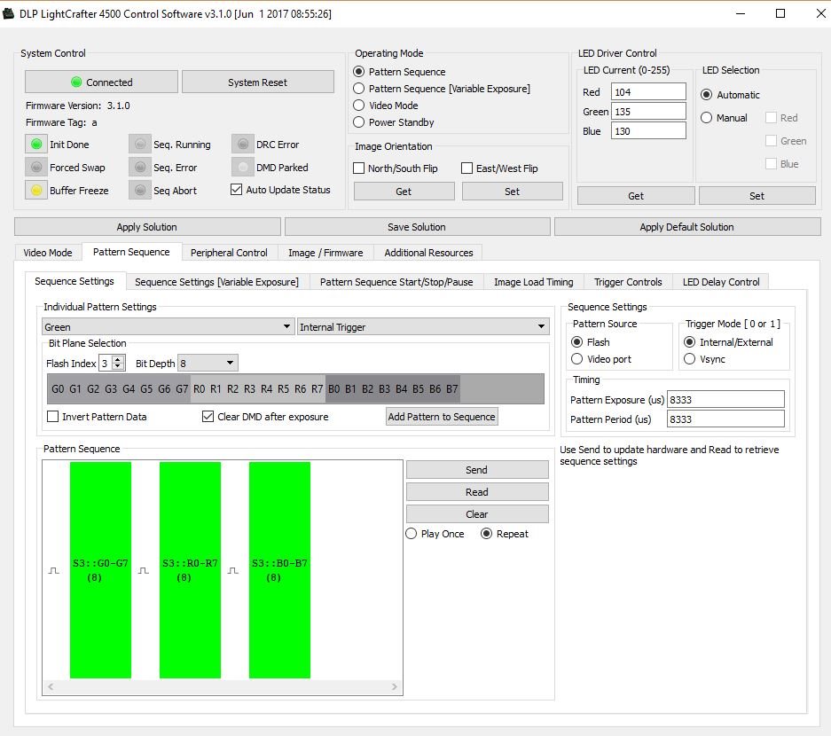

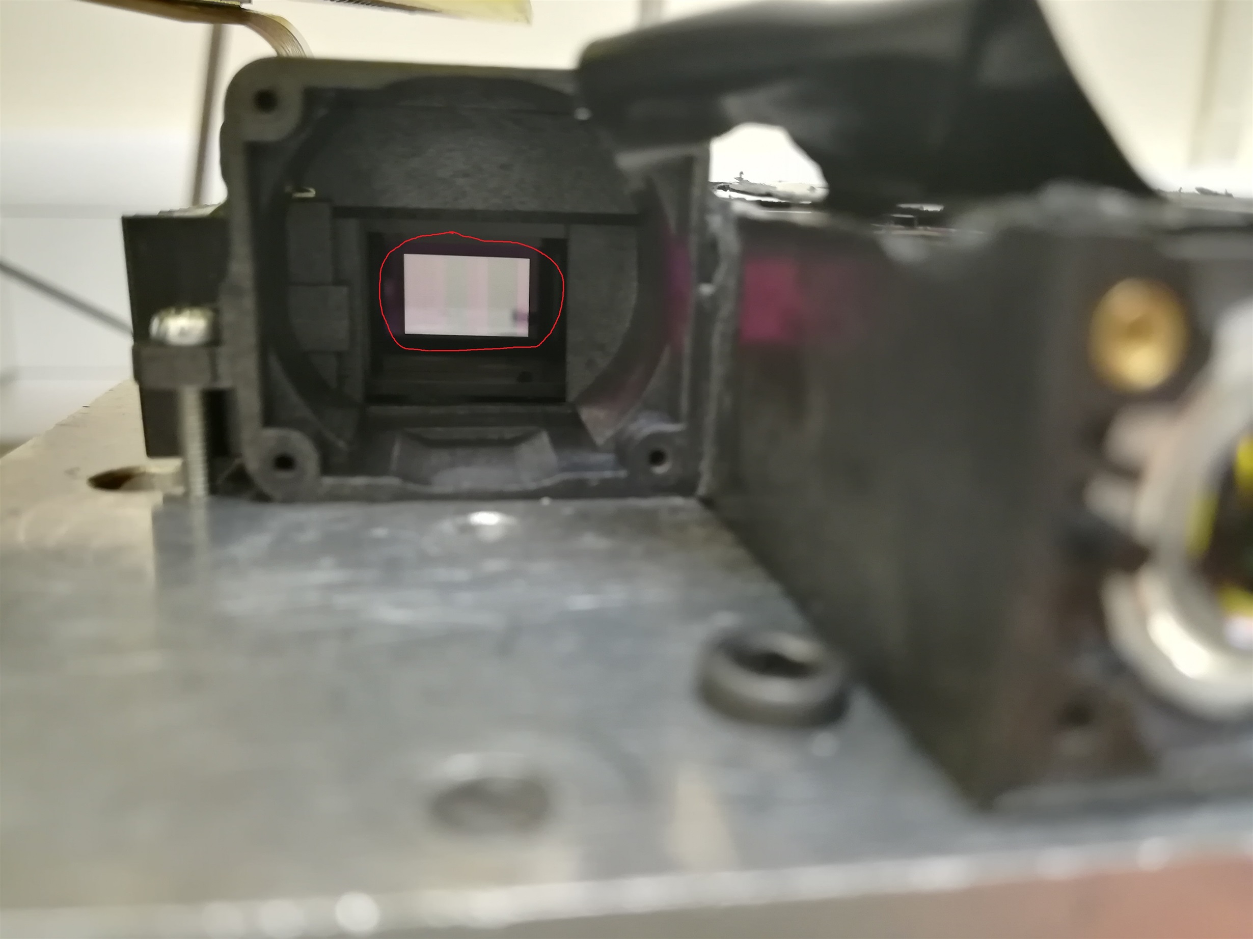

    Many Thanks. But I still can not solve my problems and have some questions,
    1. The mirror in the red circle is DMD as the photo shows? DMD is not on the side, I think it should be on the side as this post explains  https://e2e.ti.com/support/dlp__mems_micro-electro-mechanical_systems/advanced_light_control/f/924/t/278008#pi239031350=2 There are two strips on the mirror when it is on flat status.
    2. I set the parameter as the following picture shows, is it ok? I removed the LEDs, there is no light from LED actually, but it seems I have to choose one color to set the sequence. The image pattern is from 3 same 8-bit images.
    Mei
  • Hello Mei,
    I will let comment on point one as I think he may known better than I.
    However, for point 2 I would personally recommend that you have two 1-bit white patterns. The first white pattern should load an all white image and the second white pattern should load an all black image. This will effectively change the mirrors from full on and full off. If Fizix is unable to get back to you I will keep investigating on my end.
    Kyle

  • Hello Mei,
    With regards to your original question I discussed it with another coworker. The DMD is attached to the flex cable as you impliedand you are seeing some of the optics. However, you should be able to see some light coming through with the mirrors on and then no light with the mirrors off if you are continuously shinning the flashlight through the LED opening. If you aren't seeing any change it sounds like something is broken with the DMD. If it works then there might be something incorrect with the laser setup.
