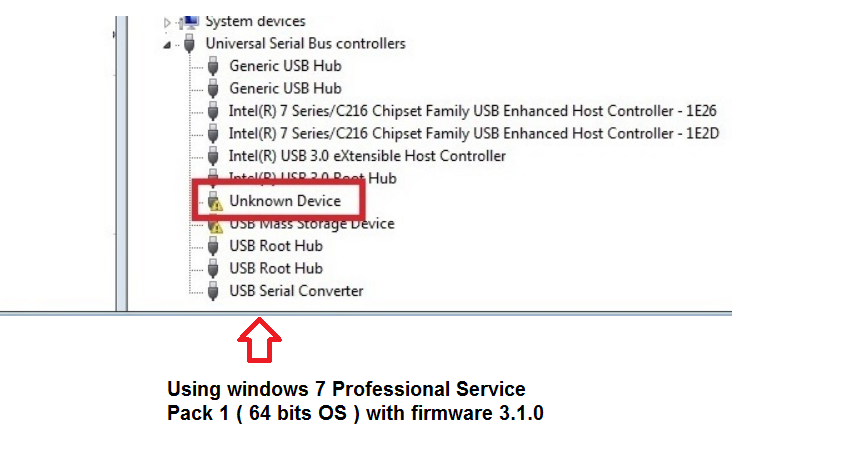

I have already tried to update and use the latest firmware 3.1.0 but the issue persists. Furthermore, after 3 weeks upgrading this new firmware, a new weird behaviour occurs where it is projecting red, green and blue light continuously even after my software is closed. I cannot risk to have an additional weird behaviour to happen in the site so I have no choice but to revert the firmware back to 2.0.0.
Recently, I found one condition that will trigger the projector turn into unknown device. It is when I plugged in the USB connection of second projector, the first projector suddenly turned into unknown device. I have to replug in the first projector USB connection for it to become USB Composite Device again.
I appreciate if you can provide some insights on this issue.

      To make question simple, we would like to know what can cause the projector become unknown device when it is working fine for few days / weeks without new USB device being pluged into / out from the PC ? We are using windows 7 Pro SP 1 64 bits and Firmware version 3.1.0. That is the problem we want to solve now. Hope your side can provide some insights into this issue. Thanks a lot.

    Even LightCrafter4500.exe is unable to connect to the projector when the Device Manager status is "Unknown Device" , so I am not sure it is able to project any image.
    It is unlikely hardware issue because one of the ways that I can recover from the "Unknown Device" status is by
    1) Right-click uninstall the driver of the "Unknown Device".
    2) Click "Scan Hardware Changes" button on the Device Manager to trigger driver reinstall.
    3) After that, the status changed to "USB Composite Device" already.
    FYI, we have also tried to change the whole projector before but the problem persists.

  • Hi Sanjeev,
    After I perform step (3), when it changes to "USB Composite Device", sometimes it works, sometimes I would still need to replug-in the USB connection for it to work.
    So far from what I observed, The LightCrafter 4500 USB is always detected as "USB Composite Device" on the Device Manager when it is working fine.

    I have tried to change the whole projector once but the problem persists. I feels like it is not hardware issue but I will still try to check the USB_ENZ signal status after I prepared all the necessary tools.
    Meanwhile, If we troubleshoot this issue from driver side, any possible scenario will cause the driver "corrupted" and subsequently caused the system to be unable to recognise the device and show it as "unknown device"?
    I notice you mentioned the projector should be detected as "USB Compliant-mouse". Is there another driver that I am suppose to install for more stable USB connection?
